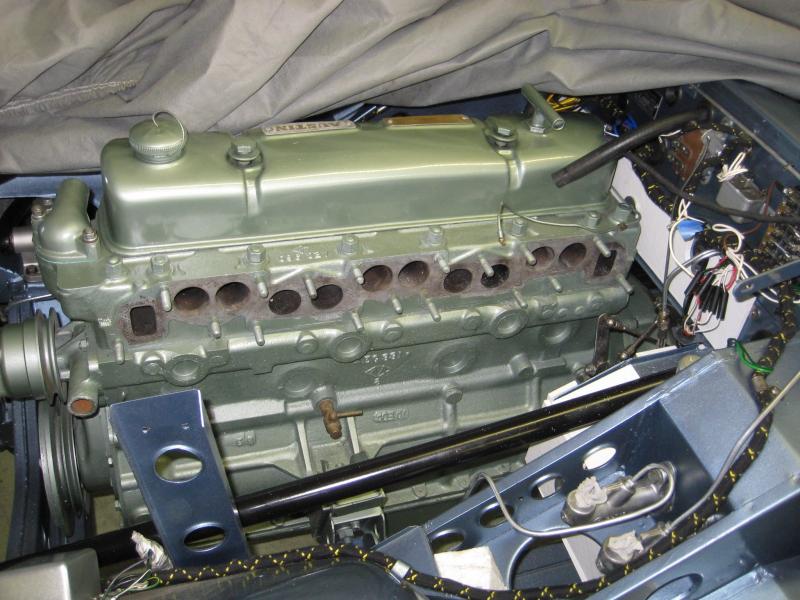

I'm finally on a roll after a long dry spell. We're installing the engine/gearbox/OD package as one unit this weekend on my BJ7. This car is undergoing a full frame off (Jule frame) restore. I have not installed the shroud yet. We're using an engine lift and leveler.
Are there are items that should be addressed with the power package out of the way? Anything that's real tough to do with that engine in place?
We have taken care of: starter solenoid, throttle linkage, mounting bolts/chased thread holes, battery cable, brake/clutch/gas lines, all painting, spin on oil filter, heat shields, suspension, motor mounts bolted on engine, crank shaft dampener, wiring harness, intake/exhaust manifolds
I'll install afterward: starter, dizzy, gas peddle, generator, Ebrake lever, drive shaft, steering gear box/shaft,
Please share any thoughts, advice, words of caution.
