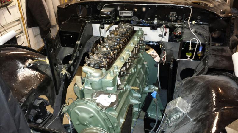

Engine installed, without the gearbox, after 10 years out of the car. What a feeling!
While preparing the install I attempted to install the clutch. The BJ7 is a transition car. I knew that but I didn't know that mid production they moved from a 10" clutch to a 9 1/2" clutch. My car takes a 10" clutch. I bought the 9 1/2" a few years ago so I can't return it. Anyone want to buy a new in the box 9 1/2" clutch kit? :rolleye:
I ordered a 10" clutch kit and will be ready to complete the rest of the drive train when it arrives. I haven't been this excited since I was a kid.
