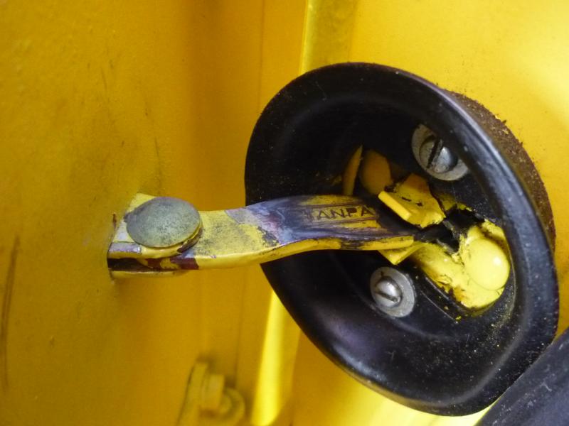

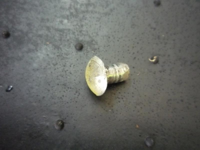

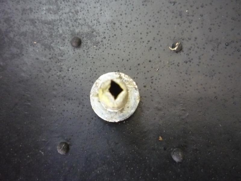

TRopic6
Ron, I believe the 4A had the same check strap as the 6. I carefully filed the bottom center of the strap pivot rivet and then used pliers to squeeze the bottom of the rivet. I was then able to pull the rivet out and separate the check strap halves. I replaced the rubber buffer at one end and reassembled. You can rejoin the check strap with a small bolt but I wanted an authentic look so put the original rivet back in. Jeff
TRopic6
Here are pictures of the complete check strap and with the original rivet removed. I used some needle-nose vice-grips to squash the flare at the bottom enough to be pulled up & out of the pivot. Its a soft metal. I needed to remove the doors for restoration and paint P1110085.jpgP1110087.jpgP1110086.jpg prep.
