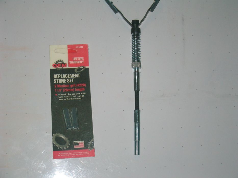

I did not get the hone yet. Is this something that my local parts place will have. Is it a certain size or one size fits all?

You're doin' jus' fine. You can get a hone at NAPA or about any good parts house. "Ammco" is my preferred brand simply because you can count on finding replacement stones for 'em. Can't expect to do that with a "no-name" outfit. The Ammco is a spring-loaded adjustable, drive it with a variable speed drill. SLOW and in-and-out motion are the "right" way. Looking to "cross-hatch" the bore much like a cylinder wall in a block.

I am going out right now to NAPA.
How should I treat the cylinder. Wire wheel, scotch brite pad, 0000 steel wool?

Mineral spirits and a cheap natural bristle 1" paintbrush is all I'd use... With the way yours look the wire wheel may be more appropriate for the outside, tho! /ubbthreads/images/graemlins/wink.gif

Next stop the garage!!
