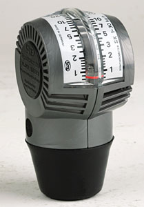

I really never liked the Unisyn. I have two of these and they work great IMHO.

poolboy
I haven't tried that one,Paul, but it looks like it eliminates the problem of placing it in corresponding identical locations on each carb.
Brosky
You can't screw up the locations and you can have one in each carb if you push them in snuggly and that makes it easy to set them perfectly at the same time.
poolboy
Sounds very "luxurious". Is there an adjustment to vary the amount of air passing thru it?
Brosky
PB,
I have the SK unit in my hand, made in Germany and there is no adjustment for the air on it. The other I bought on ebay, but it's not here at the moment. It is not an SK, probably a knock off, but it looks and works exactly the same and gives me the exact same readings.
I don't know if I'd call it luxurious, but I am basically lazy, so I guess that I would choose calling it an easier more efficient unit for the labor required to do the job.
poolboy
Just kidding. The fact that there is no adjustment for air and the plug in installation does eliminate the 2 biggest source of errors when using the Unisyn.

Brosky
Russ,
These were quite popular years ago for VW, Porsche, Weber stacks, etc. See, I am an old fart! They make setting Weber's really easy.
Ar any rate, here are a bunch of them. Just make sure that you get the one to fit the TR6 air opening.
Oh and for the record, the SK models do feel a bit heavier than the others and seem to be a bit more robust, but except for thinner plastic, they look and read the same as each other.
