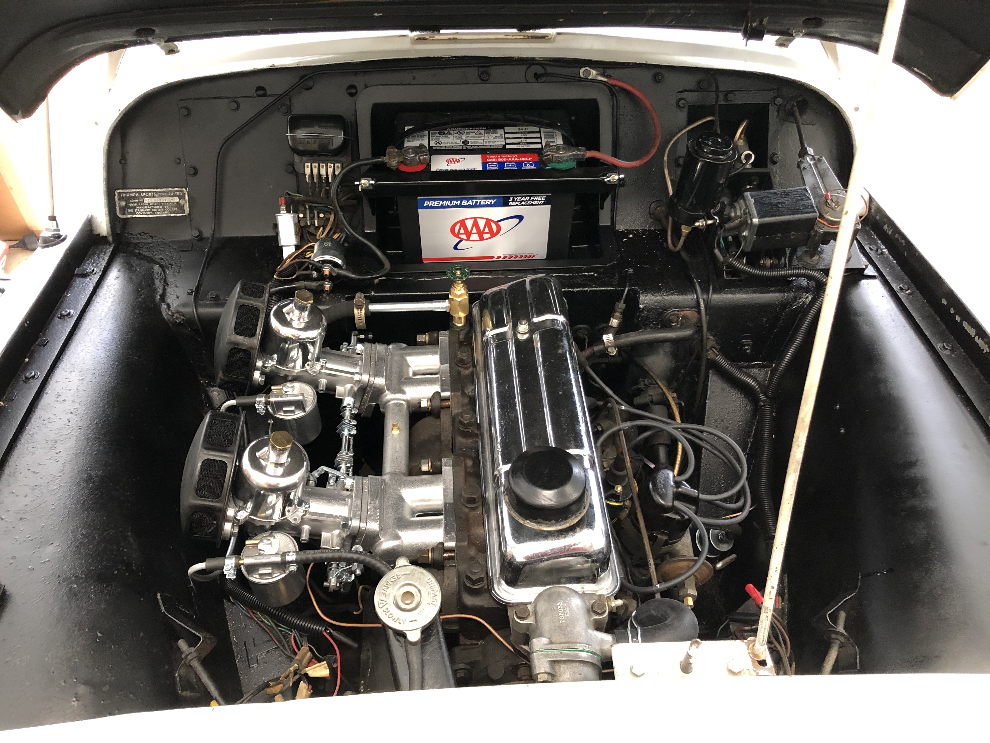

Speaking of “another carb question,” I have this problem. Gasoline flows out of the rear SU carb float bowl overflow pipe. Why is that and what fixes it? I assume the shutoff valve is not closing tightly. The carbs were totally rebuilt just this past spring.

The first thing to do is take the top off the float chamber and make sure the float is floating, it may have a hole and has filled up with petrol. Next check the float height adjustment is correct then blow out the needle valve in case there is dirt stoping it from sealing.
Graham
The causes for float overflow would be dirt in the float valve, a float with a pinhole that does not float anymore, a float set too high, or to much fuel pressure. American cars use 6 psi to the carbs, but British cars only need 3 psi. Any more and the pressure can overpower the float valve. Most of these, with the exception of high fuel pressure, would only affect one of the two carbs.
It is only affecting one carb; the rear one. And it has a replacement TR3 fuel pump, virtually identical to the original. The carbs were newly rebuilt and professionally tuned, so I doubt the float is punctured. Perhaps dirt in the valve.
thank you all.
Sometimes new parts can be defective.
Check the float is floating and clean the needle valve. There are solid floats available now which gets away from the brass float springing a leak.
I have a filter mounted before the fuel pump. A filter between the pump and carbs would help trap any crud in the system.

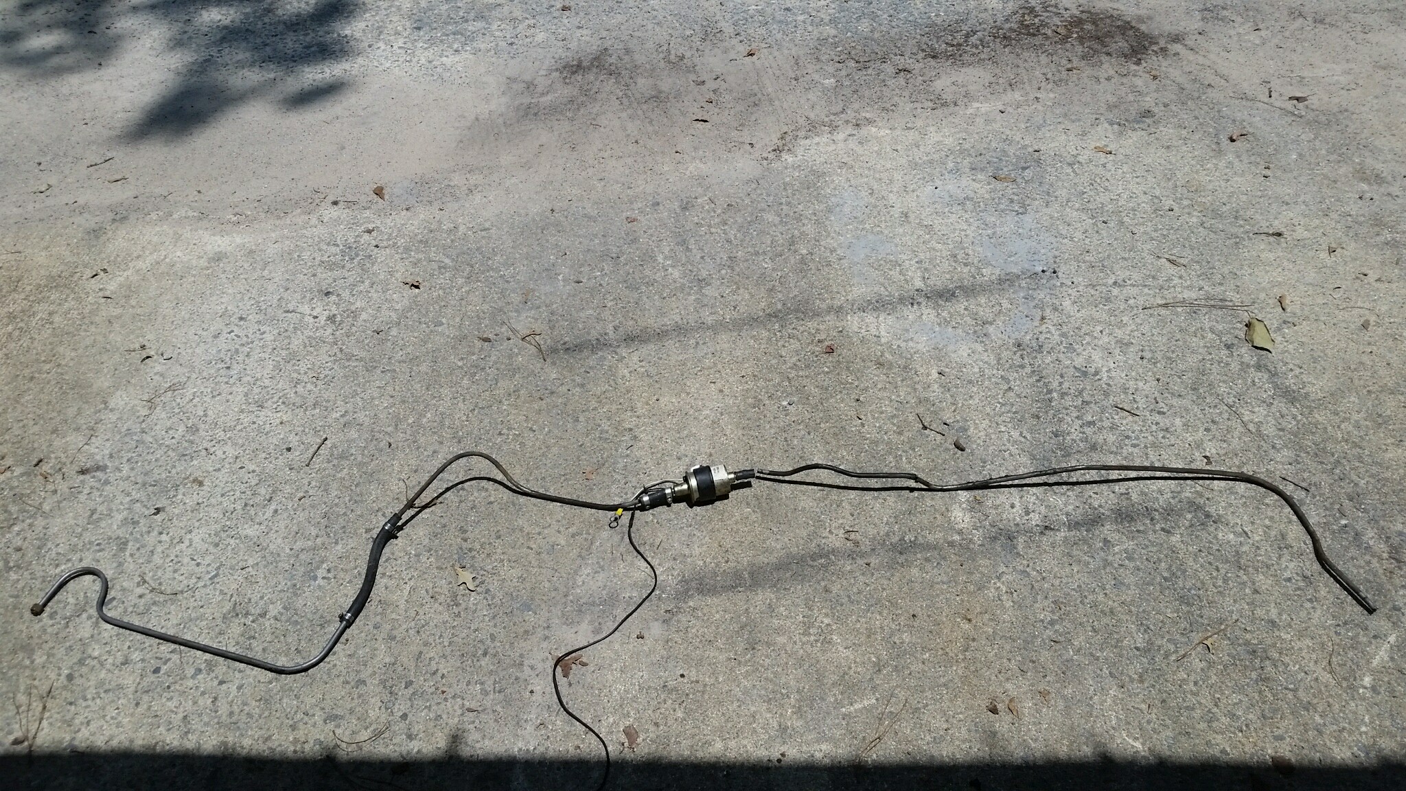

The fuel line was cobbled together from 3 pieces of solid line 4 pieces of rubber hose and an electric pump that did not work. A roll of 5/16" Copper Nickle line arrived yesterday. It is a major PITA t fit the line working under the car.
The exhaust had a large hole in it by the manifold and the rear brake lines ran over the bump stops showing evidence of being repeatedly hit as the axle tit the stops.
