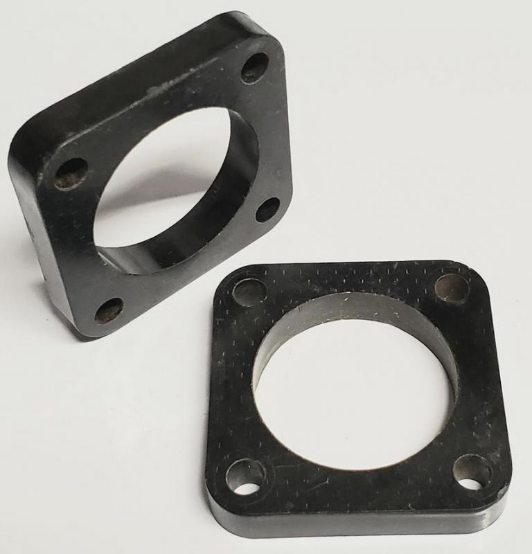

The factory thought them necessary. But they didn't live in the mountains and have to run ethanol gas. So maybe the situation has changed.
Jags used a thinner one - around 3/16" - you can get them from Joe Curto or Moss.

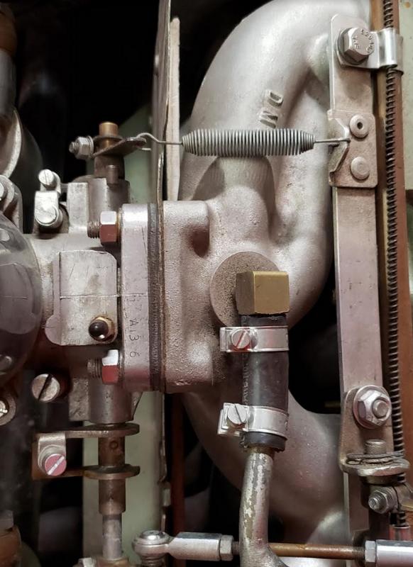

My problem is not getting them off (well, yes, that is a problem). The problem is getting the Uni-Syn seated on the carb so I can see the float height.

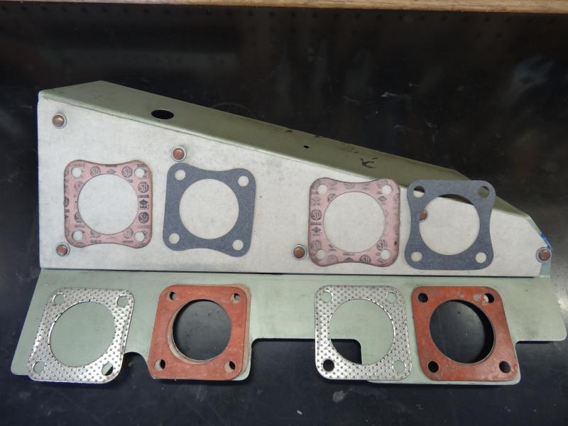

Relating to spacers, what is the correct material for the heat shield to insulating block and heat shield to carburetor.
Moss lists 4 gaskets to use, all same part number, no description of the material.
I have a collection of an aluminum and an orange-ish hard gasket. I have another two that are thinner and more flexible, one is pinkish says SU, the other is solid gray.
John Turney
The grey ones are what Moss shows on their website. They imply that the order is manifold, phenolic spacer, gasket, heat shield, gasket, carburetor. The gaskets are paper.
AUSMHLY
Thanks John.
The paper gaskets being correct, noticed both have the same shape. The aluminum and orange ones have a different shape.
What would the aluminum and orange-ish spacers be used for?
Steve, I see an imprint on your HD8 phenolic spacer that looks like there was an aluminum gasket spacer, like the one in my photo.
Is there a gasket between the inlet manifold and the phenolic spacer? (Moss doesn't show one.) Should it an aluminum spacer?

IMO the wire pointers are best - they're like a built-in uni-syn without having to remove the air cleaners.

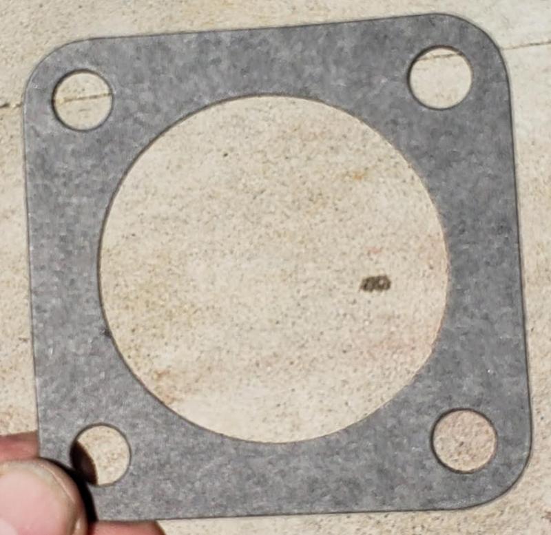

All I ever used are the gray cardboard ones from Moss:
I'm using three of these on each carb on my DMD manifold. Also shown is the thin Jag spacer. The stock Healey spacers made my front carb dome extend under the fender so I couldn't remove it.
Guessing your aluminum ones went between the manifold and heat shield.
I'm just guessing, but you might not get a good seal between the aluminium manifold and the (hard) phenolic/bakelite spacer without a gasket. I like to use the metal-faced gasket against a hot surface; e.g. the manifold.

Anderson Moment, p. 157, shows the heat shield to be outboard of the phenolic spacers. Can't tell, but assume there's a gasket between the manifold and spacer.
John Turney
On my car, which is guaranteed to not be stock, but has an original BJ8 intake manifold, there is a paper gasket between the manifold and spacer, in addition to the ones on either side of the heat shield.
gonzo
Phenolic spacers yes, but my BJ7 appears to be equipped with a series of 4 or 5, 1/16 - 1/8 inch stacked asbestos spacers. There are two of them, one separating manifold to heat-shield and the other heat-shield to carb. Gaskets I make myself.
