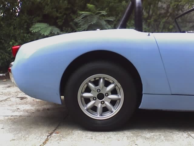

GB1
Jeff:
For the BE's, I have Minators 165x80 on mine and my brother has Chrome Moss Wires 155x80 on his.
Patrick
Edit - Added pic of rear Minator

jlaird
Oh, those wheels look so good.

jlaird
Pat, I copied your pic above. Those wheels are just too nice.
