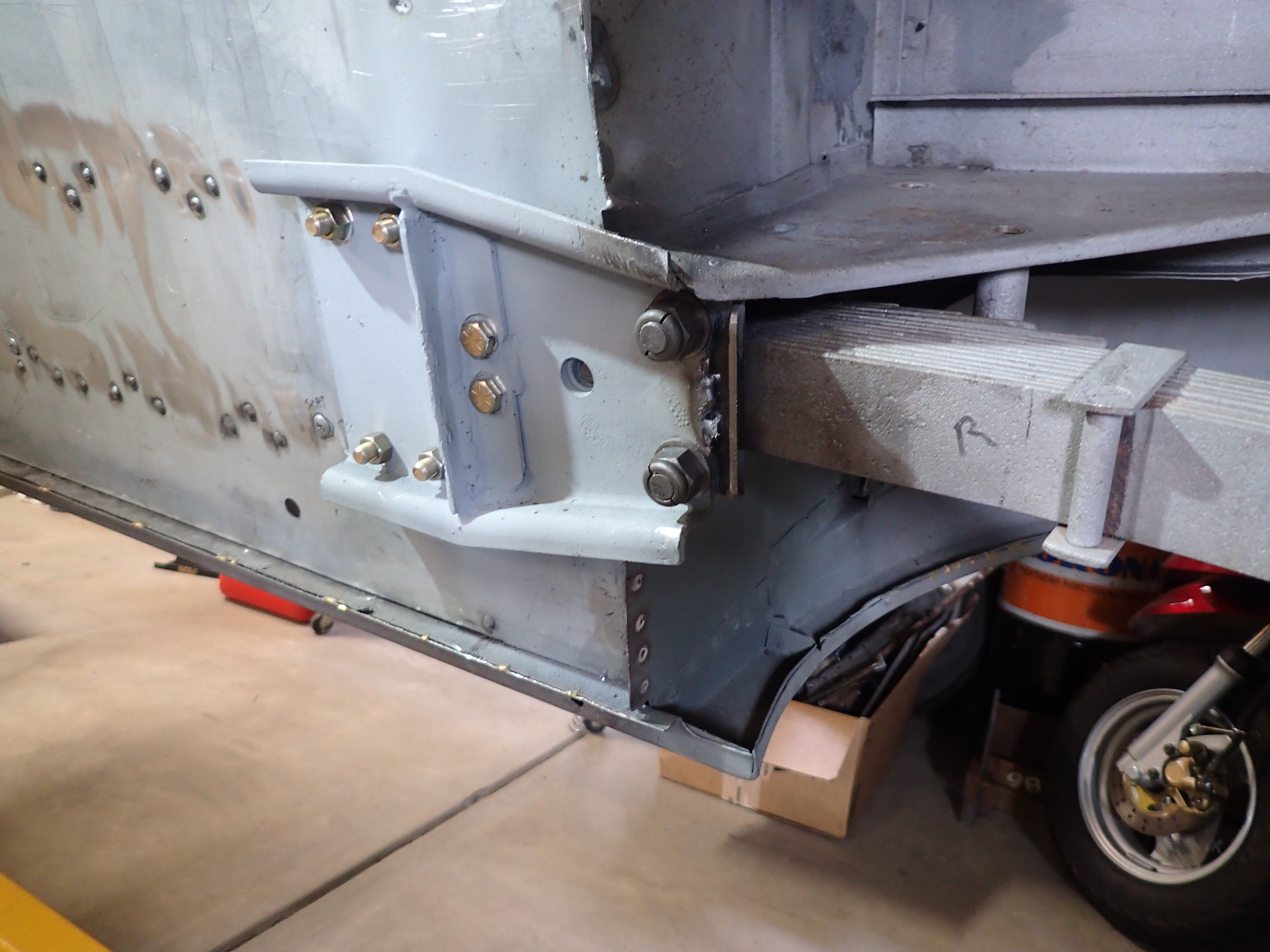

It gets more amusing the more I learn about our little red bomb. At some point someone replaced the original rear axle with one from a TR 2/3/4 - apparently to get bigger brakes. Cool. When we got the car there was a plastic shim under the passenger side springs - one of those plastic wedges one can use to shim house doors. Took me a while to figure out why - given it made the car sort of lopsided. So, out it came. Then, as I was looking at the axle limit straps I noticed one was taught, one not so much. Hmmm. What the heck. Then I noticed that the bracket for the damper/limit strap on one side was not clocked the same as the other side - hence the need for the shim apparently - the previous folks hadn't noticed the clocking issue and just assumed they needed to add the shim to get the two straps at equal tension. When I pulled plastic shim, problem was back.
Which is not actually a problem, I just made up new straps, one a half inch longer than the other. Now the bug sits the way it should and has a little slack in each strap.
It looks like your car has gotten new floors. A labor of love - good for you!
Wow, and I thought my car was messed with! Yeah, new floors, rocker panels, A pillars, sheet metal on front of footwells, behind spring boxes, bulkhead braces, etc. My skills with sheet metal origami have improved as it goes on.
