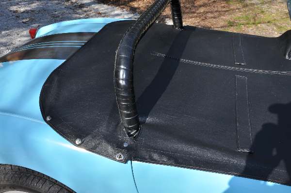

I could measure mine if you like. It does fit with the top up.
You will have to cut some on the tonneau for a roll bar.
Let me know if I can help.
Edit: 8 3/4 inches from the rear cockpit surround to the top
of the bar (not the center of pipe- the top)
35 inches from the floor to top of pipe
41 inches wide (centerline of pipe to centerline of pipe)
7 1/2 inches for rear struts to rear shelf
It's a tight fit with the top up, both to the top and to the frame sides. I don't think you could go bigger and keep a stock top.

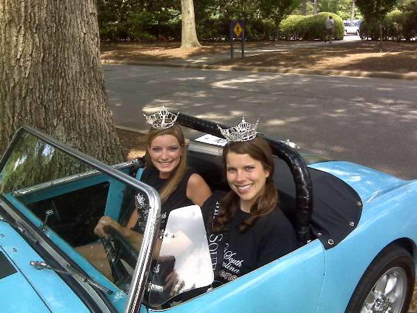

here's a pic with some passengers so you can see how short the bar height must be to clear a original top.
It's better than nothing but at 6 feet tall my forehead
is higher than the windshield. Still it's better than nothing in my book. That windshield will fold like a cheap suit if she goes over.
Defensive driving is ALWAYS the best defense against injury.
I figure if I got the time...instinctive ducking is in order.
