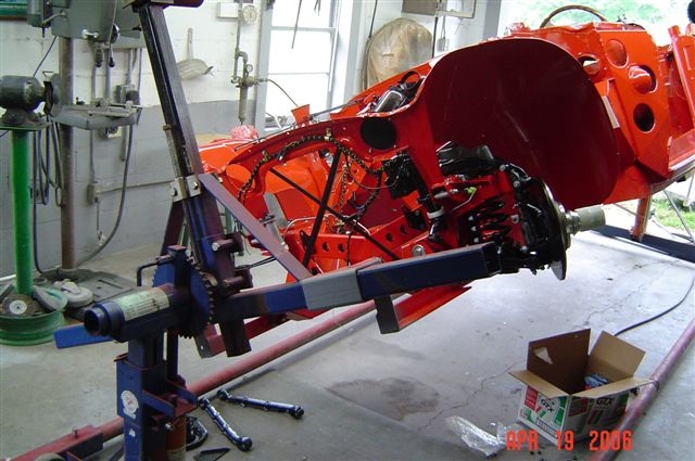

Tomorrow (4/19) I am going across town to assist in removing a BJ7 from a rotisserie. I will get some pics before we start. This car went to Jewell (sp?) to get it's chassis rebuilt and is the only Healey I've helped out with that did not need the stiffener bar across the top. An original car will flex over an inch. We connect the rotisserie to the front of the rear spring mounts and I cannot remember exactly what on the front but I will find out shortly.
Alan T
AlanT
Re: BN-2 on a rotisserie - mounting points questio
Attached is an image of the BJ7 on the rotisserie. The rear of the chassis is attached by a large piece of angle iron to both of the spring mounts. The front is attached to the bumper iron mounts.
