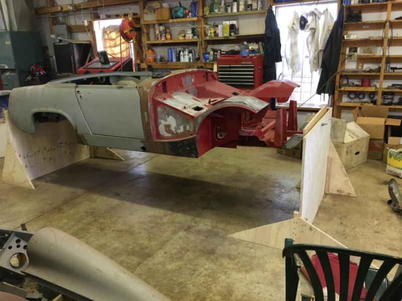

Thanks to Stan, Bluemax and JP for hints on center of gravity. We hit it close enough on the first try. It is maybe 5 pounds top heavy. So here it is, probably the simplest ever built. It may look a little light but this same one held an MGB a few years ago, including its suspension parts.

Looks great! can I only suggest you attach the two ends together, then there is no chance that one can go one way and the other the other way. Don't ask me why that might be important. :)
Good suggestion. Thanks.
