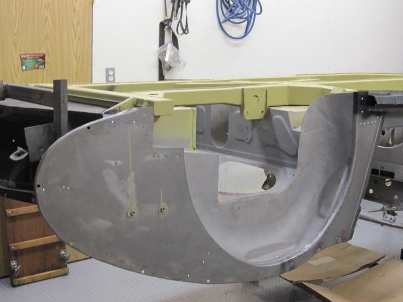

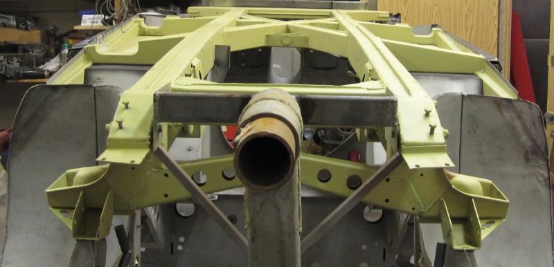

The frame and inner body structure is not all that heavy. If the car is solid in its structure, the rear bumper attachment points - two on each side - should be adequate to support the weight. I don't have good pictures of the attachment points that I used, but that is where I attached the rear rotisserie on the BN4. If the car requires extensive metal repair to the frame and near the attachment points, that work probably should be done before the car goes on the rotisserie. It likely is much easier and better to straighten and align everything before suspending the car on a rotisserie.

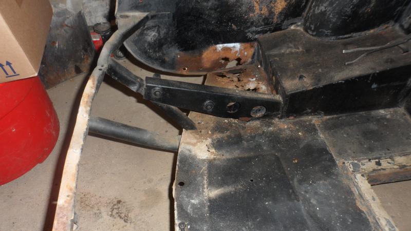

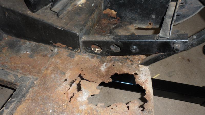

The main frame is solid right through. The floor under the fuel tank needs replacing.SAM_1685.jpgSAM_1686.jpg

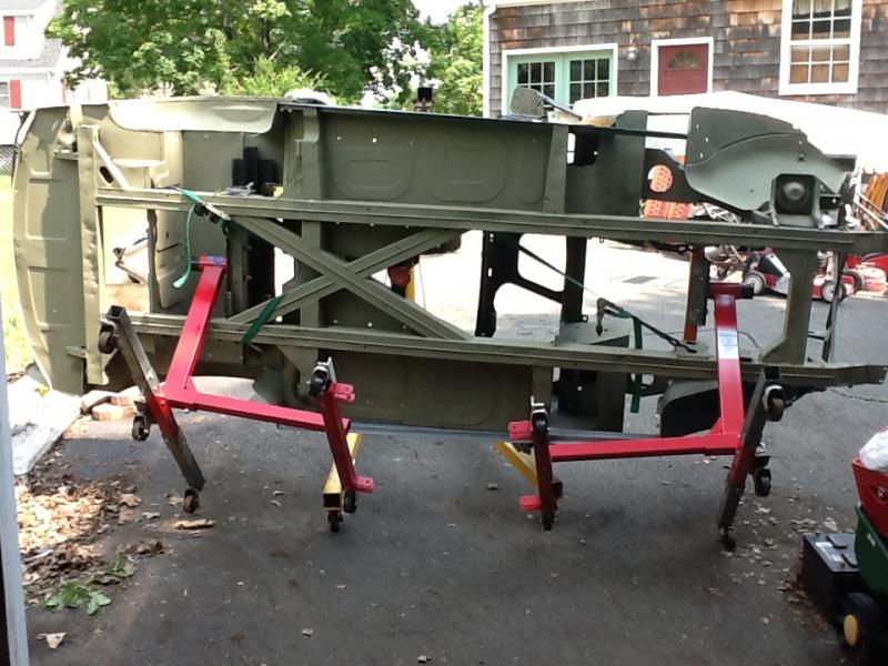

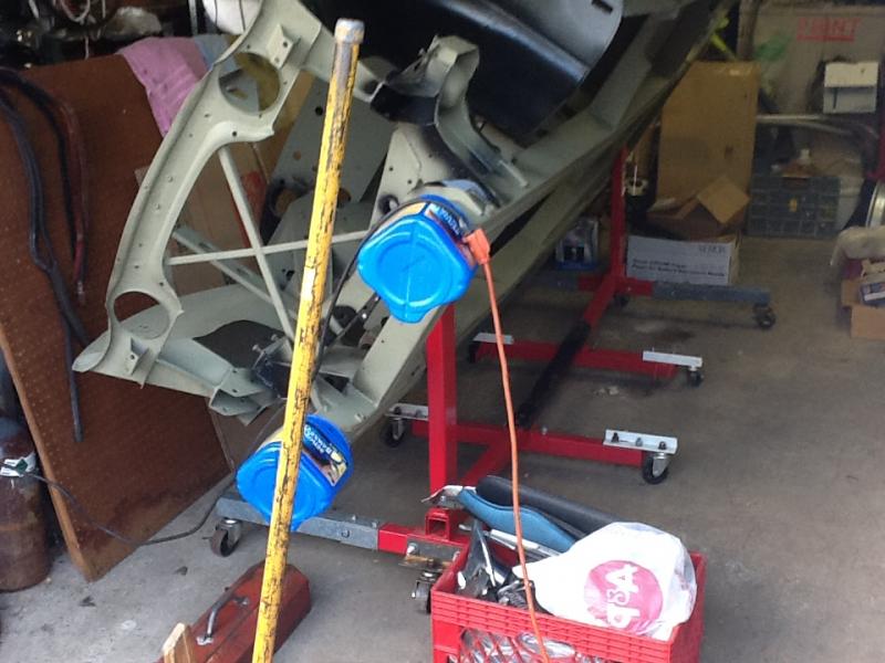

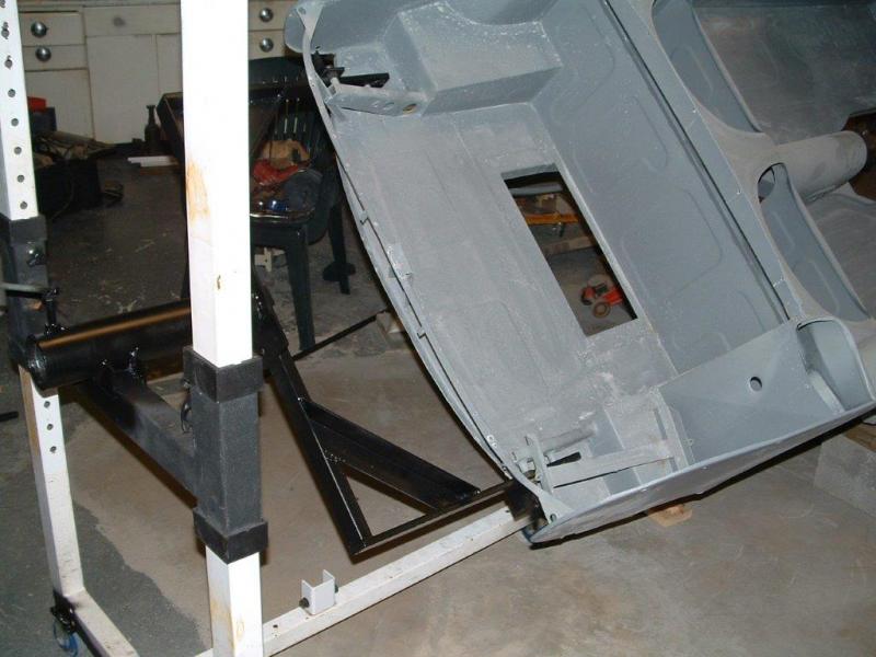

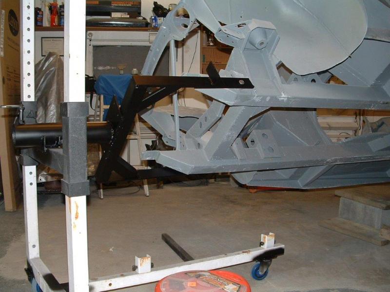

My homemade setup. I should add that my frame is a Jule, much stronger than the 50 year old original.

You can see from my pics that the forks go straight out to the bumper mounts. That connection made the car top heavy. However, I could easily turn it WITH the help of a 2nd person. I could have turned it myself but it's not worth the risk. I'm of average strength. I also had the luxury of a repurposed weight lifting rack. I could move the whole thing up and down.
I'm not an engineer, just a diy guy. I can't help you with the math.:smile:

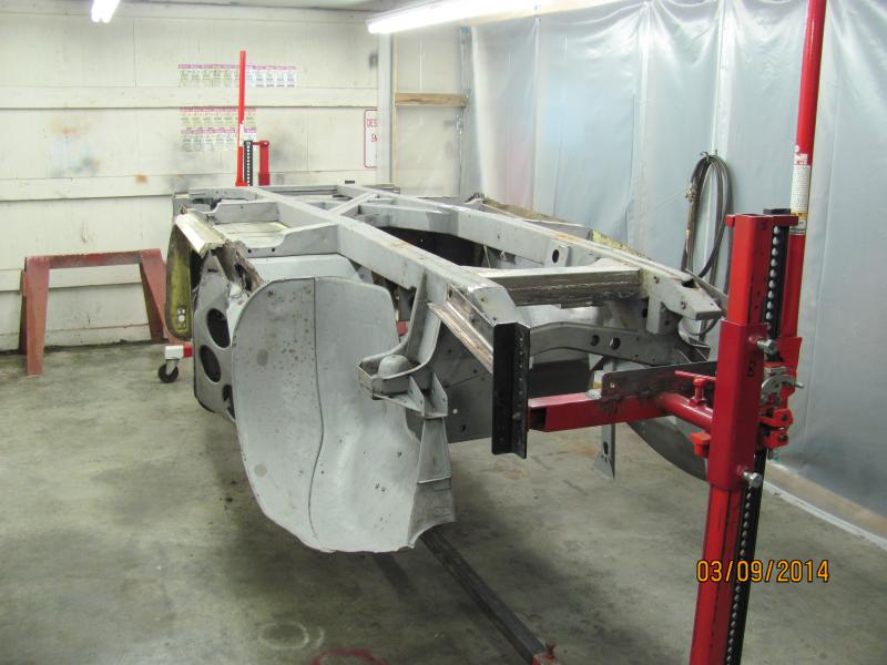

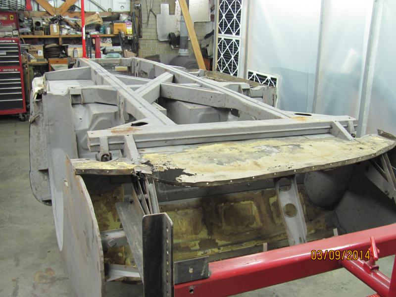

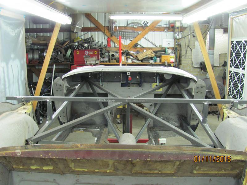

I used the bumper mounts front and rear (I was lucky in that the rear frame extensions were still good). With the stripped chassis I ended up with the center-line of the rotisserie a little over 4 inches above the top of the main frame - this is a little top heavy with all the bracing I added but is still easy to spin single handed.Imported Photos 00026.jpgImported Photos 00030.jpgImported Photos 00010.jpg

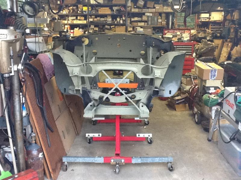

I wanted something more compact, so made a rotator that mounts inboard. Front motor mounts used, as well as the rear shock mounting plates. Two modified engine stands, with connecting link.image.jpgimage.jpgimage.jpg
