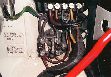

Hi, Randall,
I am a bit confused (no pun intended). You say that the torpedo fuse was Bosch and not Lucas, but here is what is on my car (the little paper in the fuse, if it is too small to read here, says "35 Lucas"):

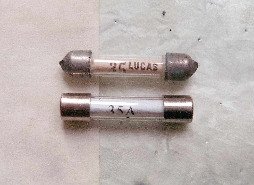

Here is a better photo of the fuses in question. On top is an original Lucas 35 amp fuse from my 58TR3, and on bottom is a 35amp fuse from Moss purchased a few months ago. You see the differences, but they seem to be the same size.

Well, live and learn as they say. I have a modest collection of original Lucas fuses and they all have conical ends (like your reproduction) except for the blob of solder. The Bosch-type fuse I was talking about can be seen here:
https://en.wikipedia.org/wiki/Fuse_%28automotive%29#Bosch_type
although I have also seen replacement Bosch fuses with a glass tube and the element inside the tube.
And the original Lucas fuses I have are only about 1-1/8" long, rather than 1-1/4".
Sorry for the negative clarity.

The 35A fuses that I got from Moss a few days ago have 35A printed on the ends of both caps. Those are the only markings. There is no paper insert. Clearly, Moss is now selling different 35A fuses and who knows if they are the 17 1/2 continuous hold slow blow type!

Well, Moss is clearly aware of the distinction; and these clearly aren't ordinary American fuses. I'd say the odds are pretty good that they are suitable replacements for the originals.
But for verification, I'd suggest taking one and loading it to 20 or 25 amps for a few minutes. If it blows, it was the proper rating. If not, it's too high.
The other alternative of course is to just pick up some AGC-20 or SFE-20 fuses and use them. They might cost you a point at concours, but there is no question about what you've got, and they are readily available practically anywhere in the US.
