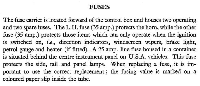

So, just to muddle the waters a bit, as Geo and Randall know, a 35A and 50A British-standard fuse is called for. P36 of the Instruction book: "The fuse carrier is located forward of the control box, and houses 2 operating and 2 spare fuses. The top fuse (50amp.) protects the horn, while the other fuse (35 amp.) protects those items which can only operate when the ignition is switched on.....".
As long as you're using "British standard" fuses, which I assume MOSS is selling, you should be all right....
Yes, but that is a fairly early edition. Later editions show both fuses as 35 amps. I can't lay my hands on my 4th ed at the moment, but both 5th & 6th show 2x35.
