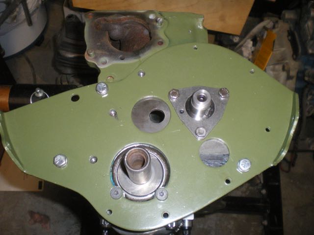

My rear seal from Gerard works great, but now I'm trying to track down an oil leak from the front.
It is dripping down from the backside of the front engine plate. I guess it could be the front semicircular gasket/seal in the oil pan, but there is no oil dripping down the front of the pan, so it would have to be running forward along the crank and hitting the engine plate.
Other possibilities?

I think if it was the timing cover it would drip from in front of the plate just at the bottom of the cover. A little line coming straight down the backside of the front plate could be the crankshaft pulley seal, but I don't really remember what this looks like. Can you reference a Moss or VB part number? I would be interested in the speedi-sleeve part number just in case.

OK, I may have misunderstood your description. If it's dripping down the back of the plate, then that would indicate that the front plate cover gasket is not sealing. It could possibly be the oil pan also, but then I would think you'd have oil dripping down the pan. I would dry everything off well, and watch where it begins from a fresh startup.

I took off the oil pan only to determine that was not the source of the leak.

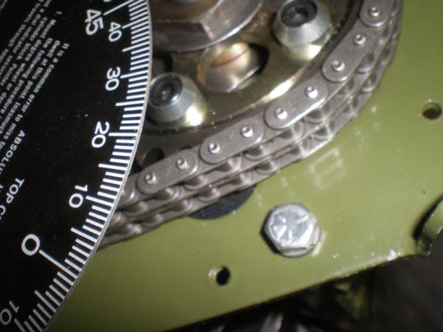

I tore down front of the engine today- removed crank pulley/dampener, timing cover, timing chain/gears. Below is a pick of the area of the leak from the internal side. I assume the leak developed between the block and the front plate (actually in this case between the first main bearing cap and the front engine plate). The leak seemed to develop right at the 6 o'clock position at the very bottom of the plate. The only thing that jumps out at me are the two little holes in the bearing cap here. What are they for?

This is the front of the crankshaft with the timing gears removed.

Are those the oil return holes thru the front main cap? My engine builder on my MGB showed me how to fit the main caps so they are flush with the block not only where the oil pan fits, but where the front and rear plates fit. After we did this I had no leaks! I also use Permatex Ultra Gray gasket maker which I really like along with the stock Payen gasket set.

I figured that's what those holes were.
This area seems to be a weak spot in the front plate seal since the sealing surface is pretty sparse, especially when the two holes are there to further reduce the surface area. Plus, those little allen screws don't draw that part of the plate up very tight.
I'll have to check the main bearing cap for "flushness". Not sure what to do to correct if it isn't flush though.

They can easily be lapped.A mill would also do, but I've never found the need to do either to the front main cap.
