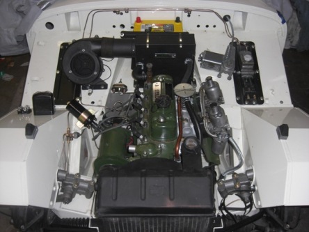

smaceng
yes, took the rad. back off and greased it up with some silicone, oriented the body under the car for maximum pushing, and turning, and BANG, she was on. Here is a pic of the engine compartment now. Still needs work on the radiator arms, etc. Next is the electrical and then the interior!
Scott in CA
