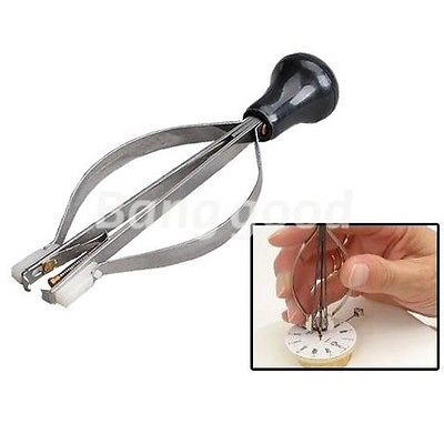

Your needle may have moved on the post. With care, it can be repositioned without removing the whole gauge. Just loosen the gauge from the dash to allow the chrome ring and glass lens to be removed. There's a watchmaker's tool for removing hands (cheap on eBay). Once removed, push it back on where you want it. You could calibrate it with a secondary sensor, or just put it to zero. Drive with the face exposed until you are satisfied.
Tedious, but cheap.
