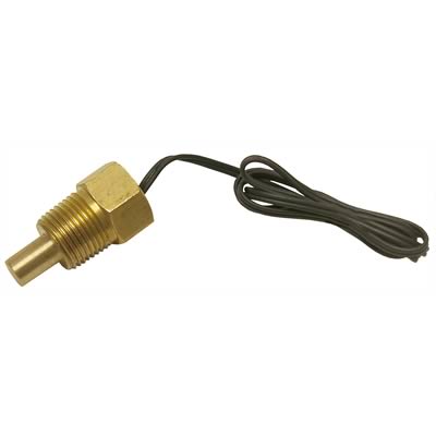

What's the thread and size? If it's 3/8 18 NPT then this might be the ticket:
https://www.summitracing.com/parts/der-16750/media/images
Unfortunately, I think it's some sort of British thread size. I tried to find a threaded plug for the hole in the radiator from Home Depot and Orchard Supply Hardware, but the threads were wrong. I think they were NPT. I finally found one that fit from Moss, so I assume the threads are not NPT.

My radiator guy had a plug that fit, not sure what the threads or size were though but it looked like 3/8 pipe.

IIRC, 5/8 x 18 tpi will fit.
I think John is right, but it is not the correct size. It will fit with persuasion and will seal and hold under pressure.

OK, but that still leaves the question as to whether or not there is a thermostatic fan switch that fits 5/8 x 18 tpi threads. The one that Rick found at Summit Racing was 3/8 18 NPT.

yes, i think it was used in a dodge colt. I picked one up at my FLAPS.
I think this is it: Beck/Arnley number 201-1158

I found a new one on eBay for $10 with free shipping. That's cheap enough to risk it, so I just went ahead and bought it. I'll know soon enough. :smile:

Make sure it is a temp sender for a fan control and not for a temp gauge. Most work thru a relay and have data on cut in and out.

Right! When it arrives, the first thing I intend to do is test it both electrically and mechanically. So far, my total investment in this "experiment" is only $10, so if it isn't what I need, it's not really a big loss. :smile:

I have it installed, but (I'm ebaressed to say) I've never connected it to try. Anyway, it did fit.

I went through this ordeal about a year ago. To make a long story short, Serck Motor Sport who is in the UK built my radiator. One of the questions I asked was what size the original bung. I was changing the bung size in radiator to 16mm for a thermo-fan switch anyway, but wanted to know. Roy who is production manger at Serck Motor Sport answered “Oh” that’s easy, the bung hole is ½ BSP (British Standard Pipe). Their are a few switches that size if you research.
