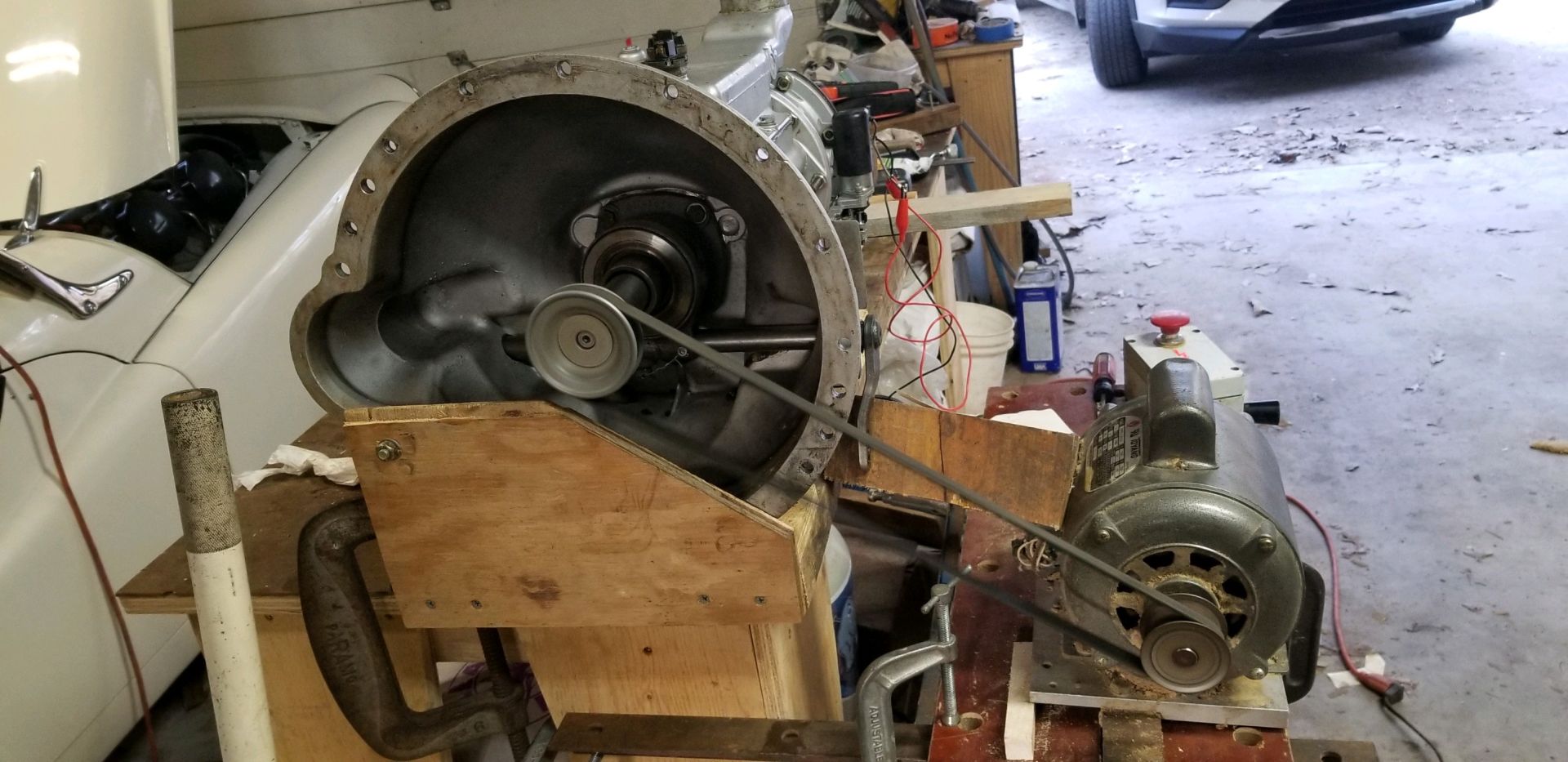

I had my OD done by a guy in Alabama. It developed a leak from the adaptor plate so I had to separate the OD from the gearbox to fix the leak. I did consider videoing but was a little unsure of what I was doing so I concentrated on the job at hand. I did get photos along the way. It went much easier than expected and is leak free now.
David
Test your work before installing it in the car.
DavidApp
From parts I had in the shop.
The motor was on my belt sander and the motor support is my Work Mate from the UK. Note the "V" pully at one end and tooth pully and timing belt to give a smooth start and that was what I had on hand. Was running the gearbox at about 1800rpm.
David
