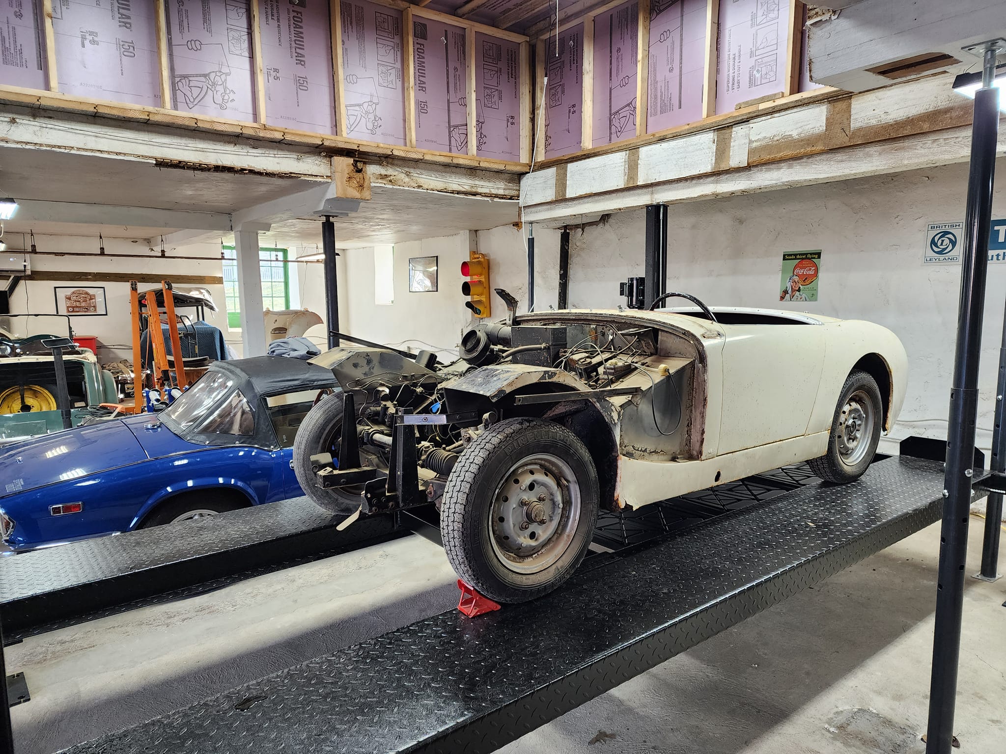

We bought our Sprite about 18 months ago. I had the engine rebuilt (bit beyond my capabilities), got it home and started tearing it down from the front to really get into the restoration. Can't put a freshly rebuilt engine into a nasty engine bay! Unfortunately last November I tore both my (L+R) rotator cuffs, so I've been out of commission for the better part of the year.
Finally got the lift cleared and my arms working - so yesterday I put the Sprite up so I can resume stripping the engine bay. I'm sure I'll have a lot of questions as I go - I have a good bit of familiarity with Spitfires, but this is my first Sprite.

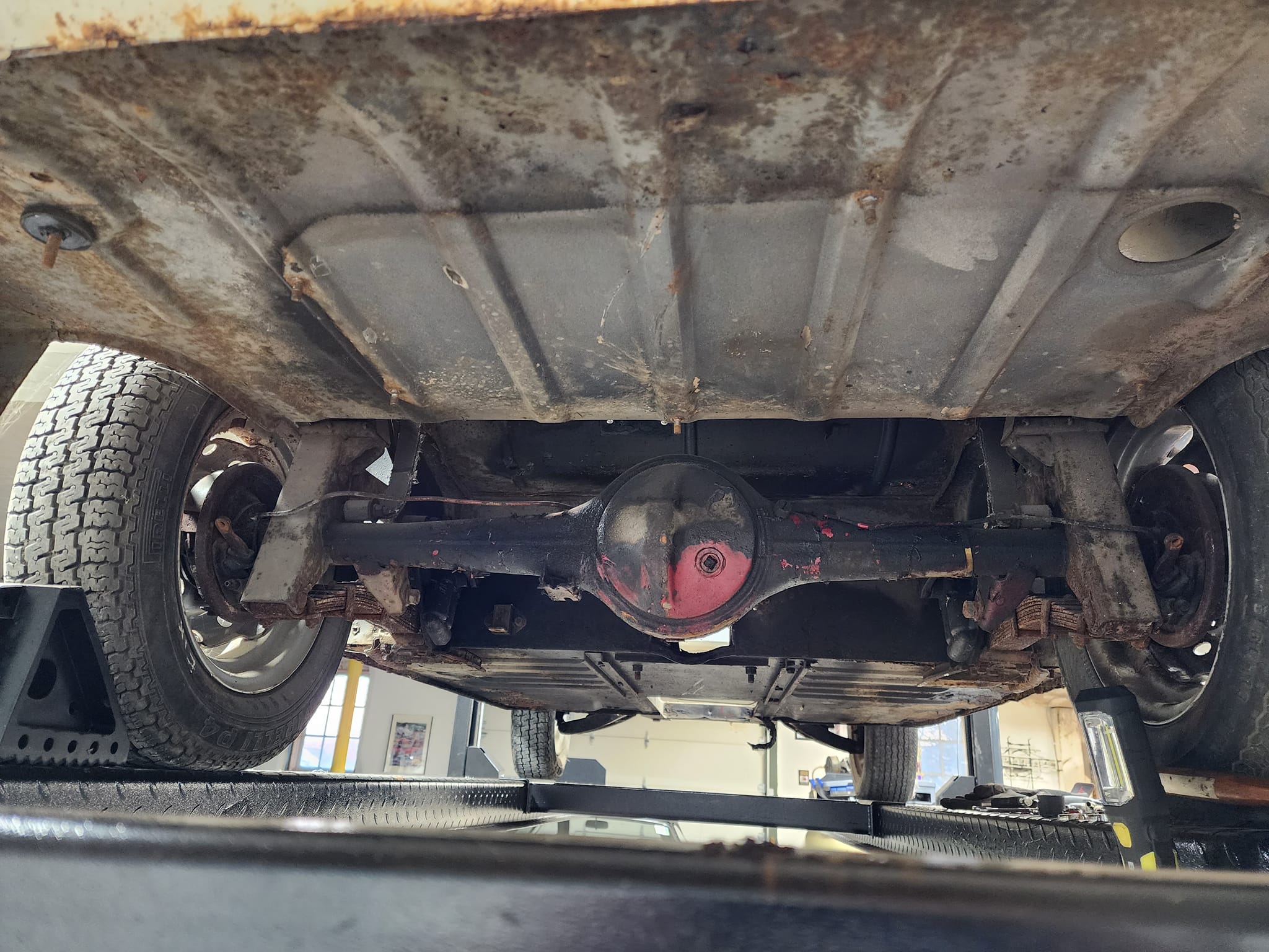

Continuing to nibble away - worked on the back end today. Got all the fixtures removed and the wiring harness out. Interior is completely stripped out and removed the steering column.

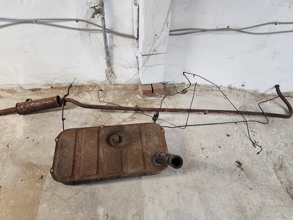

Been a couple of weeks, but spent an hour or two nibbling away on the Sprite today. Got the exhaust, gas tank and e-brake removed.

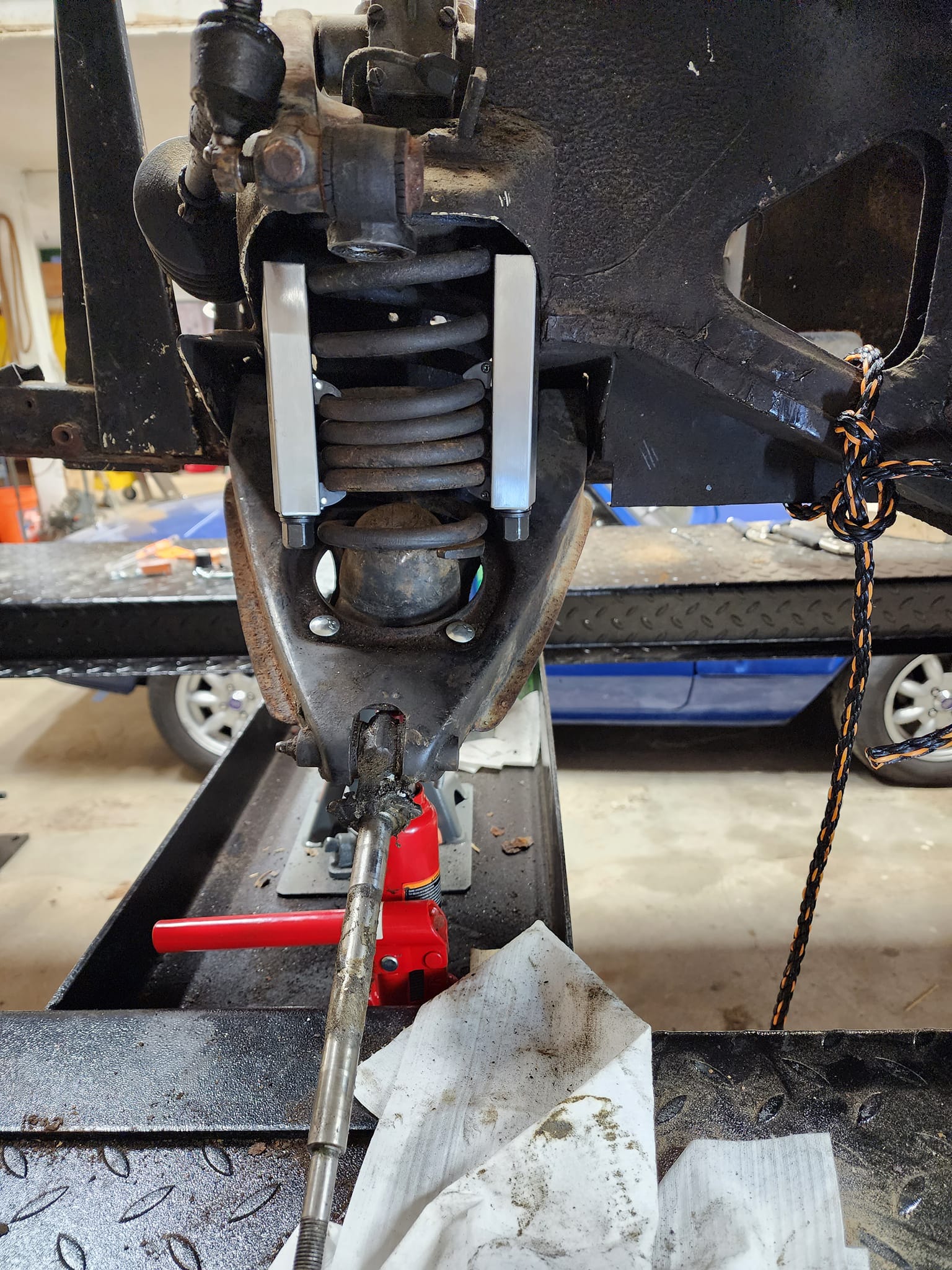

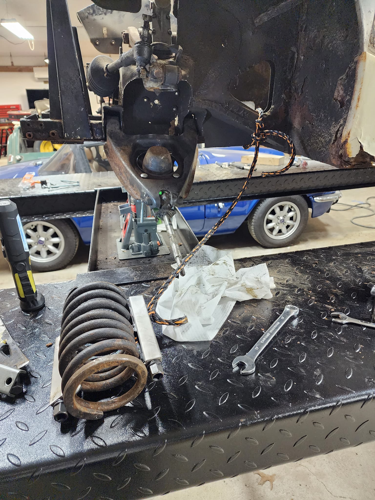

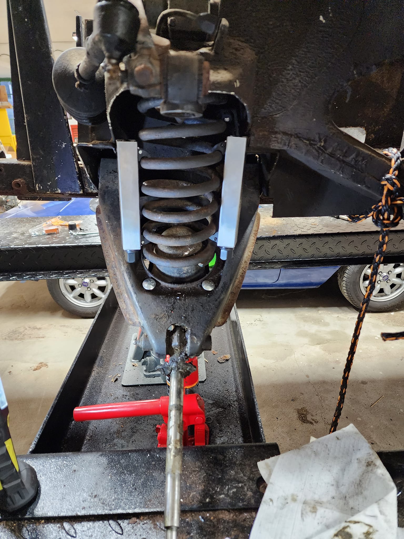

Front end suspension tear-down is almost complete. Couldn't remove the springs via the "replace the spring plate bolts with longer ones" method because the two inboard bolts were totally frozen - on BOTH left and right sides. Heat, impact gun, penetrating fluid... nothing worked. Access is a little too limited to get a cutoff wheel in there to cut the bolts free.
I experimented with multiple options with no success. Stumbled upon a pair of mini-compressors designed for motorcycle springs - they fit the small springs on the Sprite perfectly. Had the spring out in 15 minutes with a very low "pucker factor".
