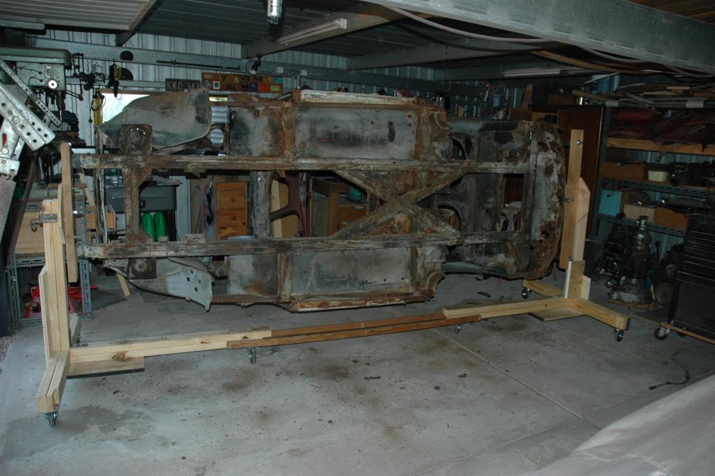

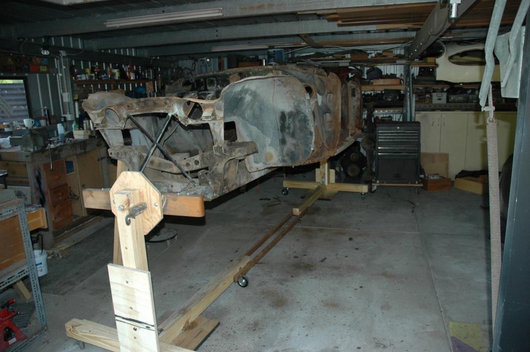

I have started stripping the car in preparation for sand blasting. I thought someone may be interested in my rotisserie. thanks to Andrea for the idea. I was going to make it from steel but I had some timber around so I thought I'd give it a go. I was a bit nervous about the weight, but the system seems very strong and operates easily. Don't think I'll climb under it however. Does anyone know the weight of this chassis?

I appreciate your utilization of wood for rotary, it was my initial choice for my personal inclination to work on wood,
but steel structure are very easy and strong
It appear correctly dimensioned for the weight of the bare frame,
I will add only more large washers, to avoid that head bolt sink in the wood
but this depend from the hardness of the wood used
also the diameter of the rotary bolt appear to be only sufficent, considering the traction and cut forces applied.
increase of the diameter of this bolt and big washers will be well used
I add the photos of your solution to my rotary Google album

thanks for the reply. Yes the wood is hard. The rotary bolt is 5/8 inch, probably should be 3/4. But then, a larger hole might weaken the wood. The car was built on February 11, 1959 so yes, it is a very late one.

Regarding your question: "Does anyone know the weight of this chassis?" About 380lbs is what my 58 BN4 weighed after media blasting.

couldn't help myself and I had to post this reply to the "off to the sand blaster" and "how much does the chassis (scuttle) weigh?"...I am restoring a BN4 59 and 380 is about right for mine, until I media blasted...........then I was down to about 250 lbs................you will most likely be surprised at the loss of metal and the things you will find! rust/ damage /rust/damage..........makes it fun. I repaired and replaced a lot. Learn and enjoy. best of luck

Hi Matthew and welcome to the Forum. I'd be a little afraid too. I think the center parallel boards aren't sufficent. You could buy a large pipe and just insert over the center boards for added strength. The chassis only weighs about 250/300 lbs but it's the rotating that bothers me.

I like your timber rotisserie, looks the dogs mate.
I am in the process of knocking up an engine stand from my supply of scrap sections, hope it works as good as your timber construction.

Thanks for that Doug, one more thing for me to worry about:rolleye: I am expecting to lose metal: sills, rockers, boot floor. Well at least it saves time cutting!! But the chassis is in very solid condition for its age. I'd rather lose metal than carry out repairs and then have blasting done. At least I know where I stand when it comes back. Johnny, I'm not quite sure what you mean by "central parallel boards", do you mean the timbers that link the two sections together? I agree, they are not strong enough. I'll take your advice on that.
