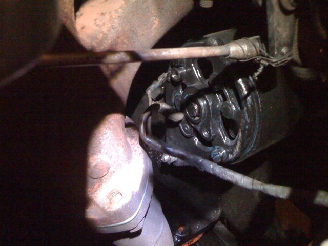

sure, should I take a pic of the generator(or maybe it's an alternator)? I do know for a fact, everything is still positive ground. I'll go snap pics now if you let me know what to take a picture of.
Andrew Mace
Does it look more like
(generator)
or more like
(alternator)?
doughairfield
doughairfield
ok, I went ahead and attached some pics. So is this an alternator or generator?
