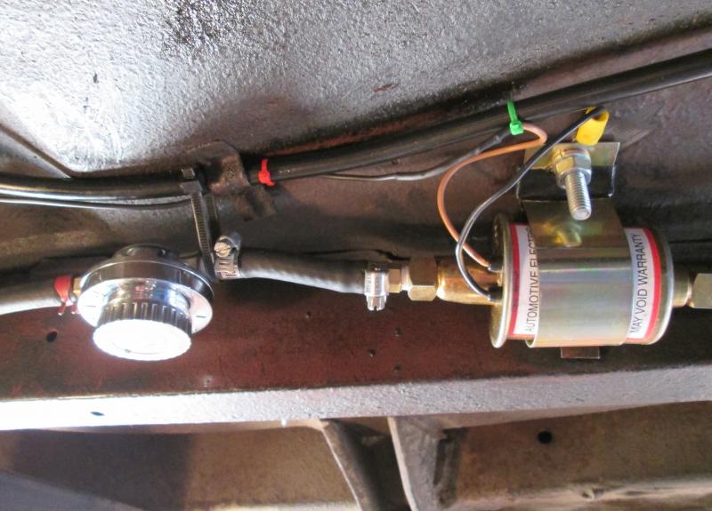

Although the mechanical pump is reliable, I do carry an electric spare to get me home just because it can be fit up in minutes vs the time it would take to R&R the mechanical:
Clips go to a ground and the white wire terminal of the coil. Hoses connect from the tank feed (5/16") to the carb feed (1/4").

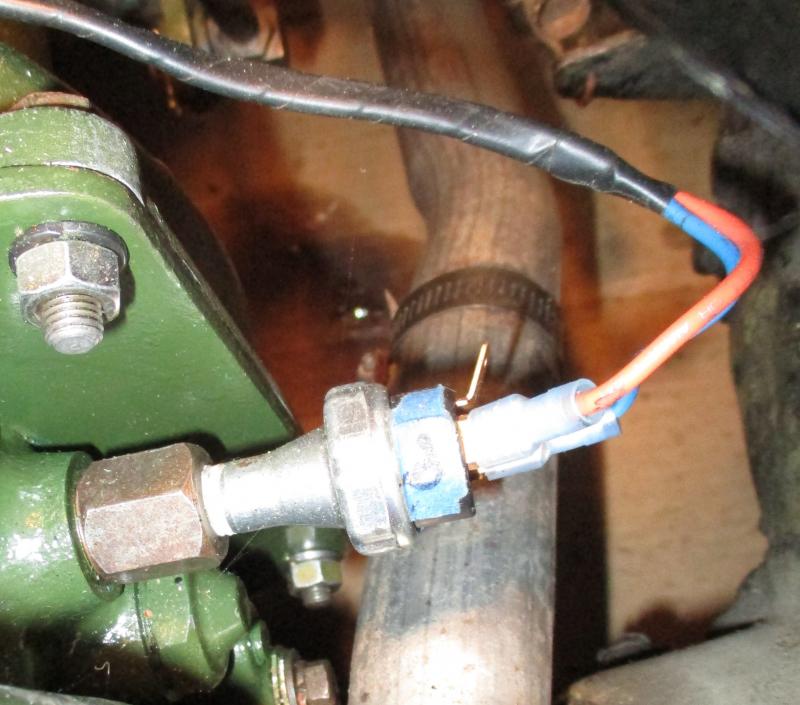

I have installed the airtex electric fuel pump and regulator on 4 Nash Metros and a "safety switch" which cuts the electric fuel pump when oil pressure falls
in the oil gallery where the switch is located--the safety switch is activated when the oil pressure rises to about 6 pounds, and on shutdown--stops pumping
when the oil pressure drops below 6 pounds--------
