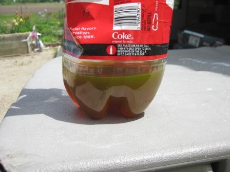

This is the color of the coolant that I drained out. What color should dexron III be? This stuff looks like swamp water.

That's the clour of Dexron....except you want green anti-freeze, not red transmission fluid.
Japanese antifreeze is red, and maybe new Jags call for red, don't know.
Does the float.....float?
Clean the parts, flush it all out, use a toothbrush on the moving bits, re-assemble and try it out!
