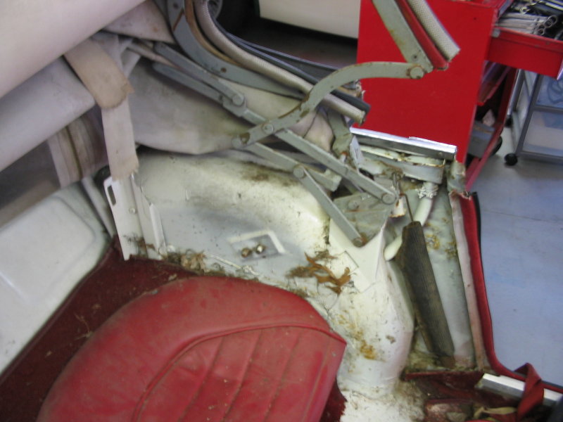

You look like your as far down as it goes , and yes it does not sit up proud of the shroud. The top boot covers it.. I'm at the same stage with a BJ7 . Could you take a picture for me of the long spring and where its attachment loop is located? I'd appreciate it. The car I'm putting togeter came to me in pieces and those little clips for the spring are missing. Kevin
Hello Kevin,
Both the top of the spring and the bottom of the spring should slide through a hole. You'll notice I screwed a D-Ring in the bottom hole (that the spring should pass thru). That D-Ring makes getting the spring attached there much easier. I don't think that added one inch affects the spring tension. Others may chime in with their thoughts about that.

Thank you, thank you. Just what I wanted to see. Have you checked the fit of the top frame with the doors rolled up? My top frame was tweeked or something and I have hours messing with it to get it to fit with the door glass up. Kevin

Brinkerhoff said:

I've never seen a spring attached to that D-ring before, and I've worked on plenty of original cars.
The spring hook goes into the welded pad on the inner sill (where the D-ring mounting screw is).
