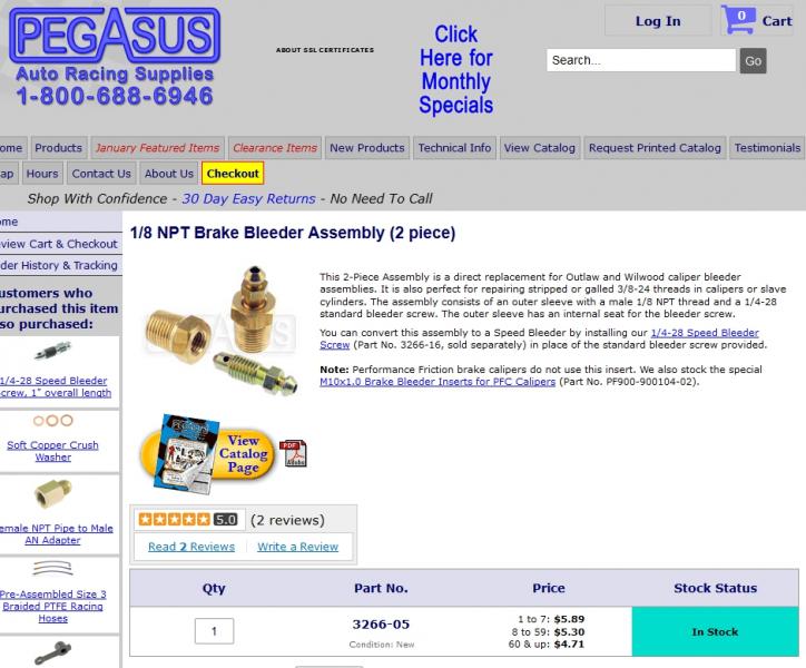

You could repair your sleeved cylinders with this:

Thanks guys. The one cylinder has a small crack now so I'll need to replace that one. The other side is not cracked nor are the threads striped. The bleeder just doesn't seat very well.
I do hate to replace these brass sleeved originals but it's probably the best option. The question is with which manufacturer?
