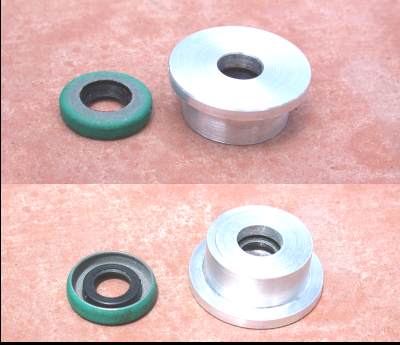

Thanks for the replies. I was beginning to think that no one else was having any problems with these things. I have managed to get three of these units (one off the car, 2 from e-bay) and have taken them apart. One was apparently rebuilt and then shelved, large piston stuck! Heh, this unit also had some bad dents in the vacuum pot, wonder why.
Currently I am trying to source a 5.5" PTFE or vitron wiper seal to replace the leather on the large piston. I have also replaced the seals in the 'hi pressure' bore (.75") with industrial vitron seals and made an additional new wiper seal that replaces the plastic spacer that is next to the vacuum pot in this bore(attachemnt). I think that this is a problematic area and a primary source of the fluid leakage that plagues these things.
BTW - The seals in the control bore (.625/.437" ) appear to be the same as the seals in the big healey clutch master cylinder!

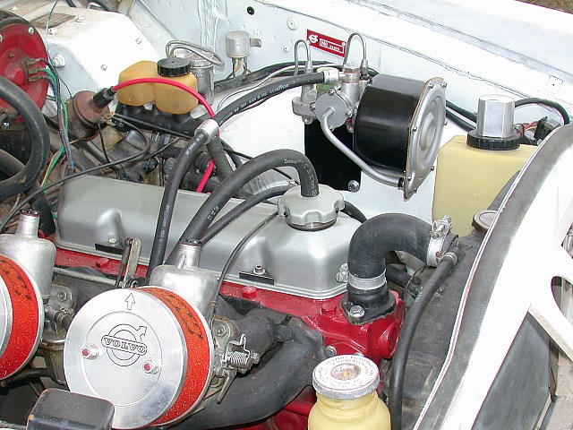

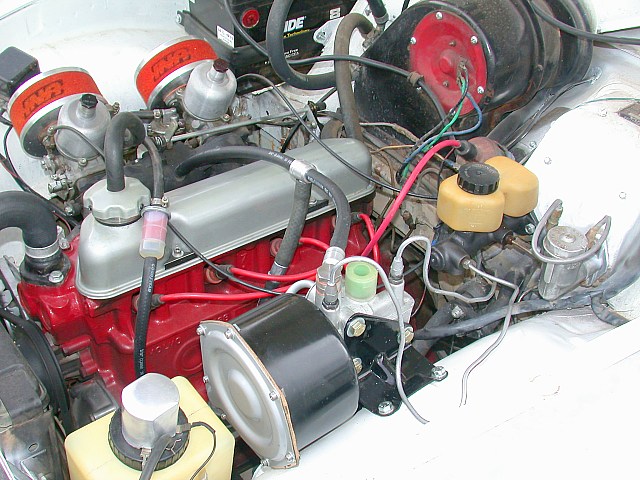

Here are the results of my MK2a servo experiment (attached). The dual MC is an ATE unit off a Volvo 164 the Girling servo has the best parts of several that I had gathered. As I outlined earlier the internals have changed a bit and I machined a new seal for the vacuum piston out of PTFE (I did source a vitron that would have worked but I wanted the NON-STICK option after hearing the horror stories) PTFE is also very inert so it won't be bothered by brake fluid, or anything else...much.
Ultimate stopping power is not really improved, but brake effort and feel are, very much so. IIRC there was always a little hesitation between the application of peddle and braking results with the old servo, that is gone now.
Note the small green UNI filter on the servo air intake, I am sure that's what the improvement is due to!
Cheers!
Dave G.
P.S. Disclaimer - Do Not try this at home! - your milage may vary - contents may settle due to shipping - If you try this on a girling servo, you do so at your own risk!

Attached is the flip side of the installation.

I’m not an expert so this is a question, not a statement. In the photo, it looks like the vacuum line from the manifold to the booster T’s off to the crankcase. Would that T rob the booster of vacuum, making it less effective? My Healey has the crankcase and valve cover venting to the air cleaner.

If you look at the photo you will see that there is a hose to the air cleaner from the filler cap on the valve cover. Also in the 'T' connection you will see a PCV type valve at the bottom of the T. As I understand it, in this vintage Volvo the line to vacuum is only active if there is enough crankcase pressure to activate the valve in the T and let manifold vacuum normalize the pressure. On an engine in good shape, I doubt this would happen very often. A year or two later Volvo went to another system and the hose to the air cleaner became an 'intake' for a valved draw to manifold vacuum.
I am thinking about adding a reservoir to this system but I am going to wait and see if it really needs it.

I thought the booster had to physically/mechanically interact with the master cylinder... Thats the first one I've ever seen seperated from it. Interesting!

KP wrote:
"I thought the booster had to physically/mechanically interact with the master cylinder."
It does - but it is physically/hydraulicaly interacting - in my set up, the front half of the MC supplies pressure to a 'control cylinder' that valves the supply of vacuum/ambient air pressure to the front end of the vacuum pot thru the line seen on the 'flip side' photo in my post above. this moves the pneumatic piston rod into the hi-pressure bore where it shuts off the lower pressure side and pushes the plunger at a 2:1 ratio for the power part of power brakes. This, in turn, acts on the small end of the control bore (also at 2:1) to modulate brake pressure by pushing back the control piston regulating the supply of vacuum/ambient air pressure to the vacuum pot, a typical analog control loop.
There was a photo of a 69 duetto alfa somewhere here that uses the very same concept only it has ATE components and had two of these 'remote' boosters valved for the right front/rear brake balance, much like the 007-ish AMs, IIRC there were some cars (lambos?) that varied the balance by sensing suspension position (nosedive) to regulate the two boosters!
