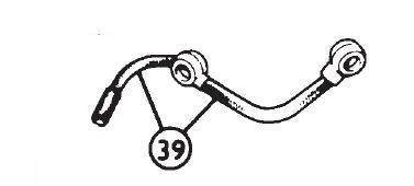

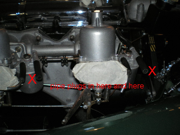

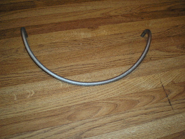

After going thru all my fuel and hydraulic lines today it looks like I may be missing the fuel line that goes between the two carbs. I tried to get an idea of what it would look like from the big three catalogs, Piggots books, and the factory parts book but no luck. I'm not even sure which one to order. Does anybody have a picture of the correct setup, or part number?

The carby link pipes are shown in the Moss Motors catalogue under "fuel system".
Your carbies look to have the last of the banjo fittings, which took push on rubber fuel hose.

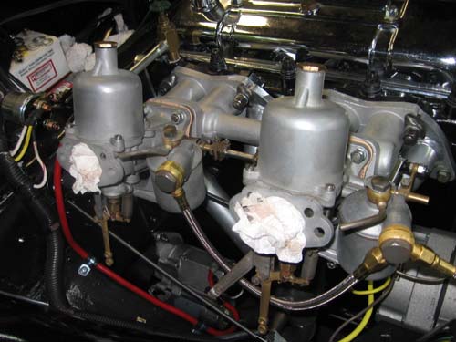

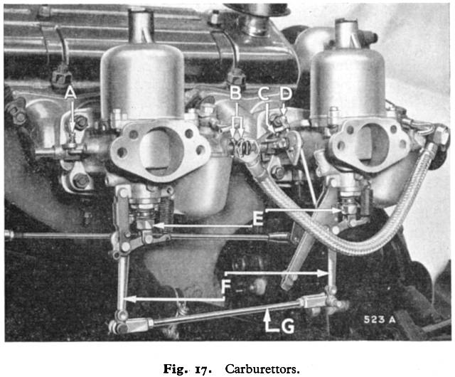

Factory P/N for those carbs was 203120, I believe. TRF has it listed under that number, Moss has it listed as 376-278. Here's a photo from Practical Hints 4th ed.

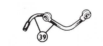

And here's a blowup of the Moss diagram

As Viv mentioned in his reply the banjo fittings look like a slip on type. The pictures from Don and Randall look like they would be a threaded type fitting on the ends of the hose.
Do you think I have incorrect hose barbs on the banjo fitting for the year of the car?
Randall the Vin for my car is very close to your 56 TR3. I'm thinking over the years someone replaced the banjos to a later style fitting, and just ran a hose with clamps between the carbs.
It looks like I could order the hose from Moss 376-278 and then remove the banjo fittings that I have and replace it with the new Moss part and it would be correct.

IMO, what you have are banjos that have had the original hoses cut off of them. They are just hose barbs underneath. Of course it would work to just clamp some rubber fuel line onto the barbs (which is what my car had when it came to me), but AFAIK the factory always supplied the hose already fastened to the banjos with crimp sleeves (very similar to what Don shows).
So yes, to be most nearly correct, buy the assembly from Moss or TRF and keep the banjos you have as spares.
At the moment, my 56 is wearing the carbs off of the 59 with the later "push-on" fittings. Someday, if I get bored, I might rebush the originals and put them back. But most likely I'll follow my usual routine of driving it until it breaks, then fixing it and driving some more :laugh:

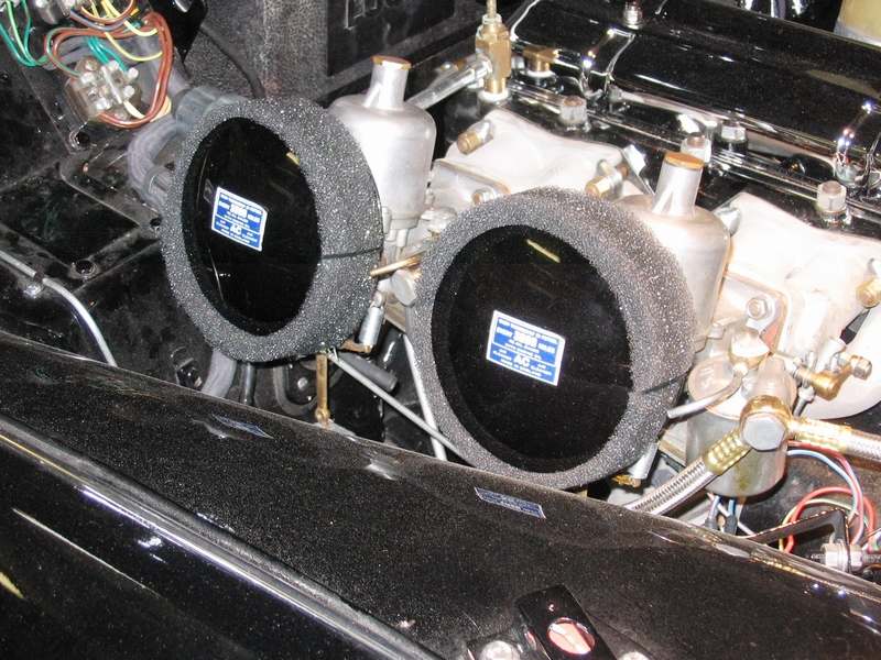

Here is the set-up that Moss furnishes. You will notice that the front carb banjo has screw on fittings. The rear banjo has a crimp on.

The braided hoses shown in my photo above was a new unit made by a local hydraulic repair shop. I took them the original banjo fittings and they cut and put on the two new lengths of hose you see with new crimps just where they were originally. Randall is right in that the crimps don't look exactly like the original crimped brass ends. But this hose works for me. I still have two complete original hose sets which I plan to keep shiny for installation at judged car shows. This way I'll know they look correct for my car.
If Moss sells them with screw-on fittings instead of the tubular brass crimped on fittings, then IMO, they are not original nor do they look original.

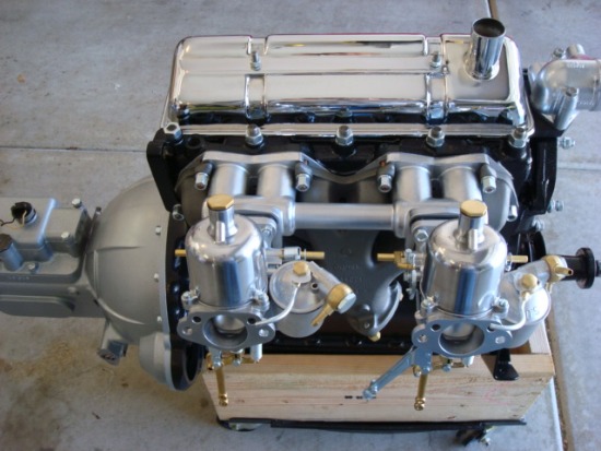

Here are some pictures of what came on and is going back on my post 60000 commission number 3A.
Cheers, Tinkerman

Thanks for all the pictures, and information. I had the same idea Randall had late last night while watching a movie that the hose had been removed from the fittings. One more thing to put down on the parts to be ordered list.
