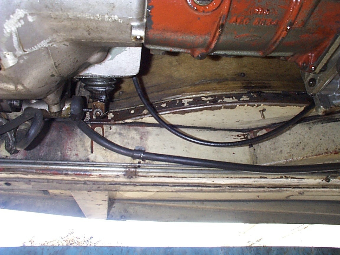

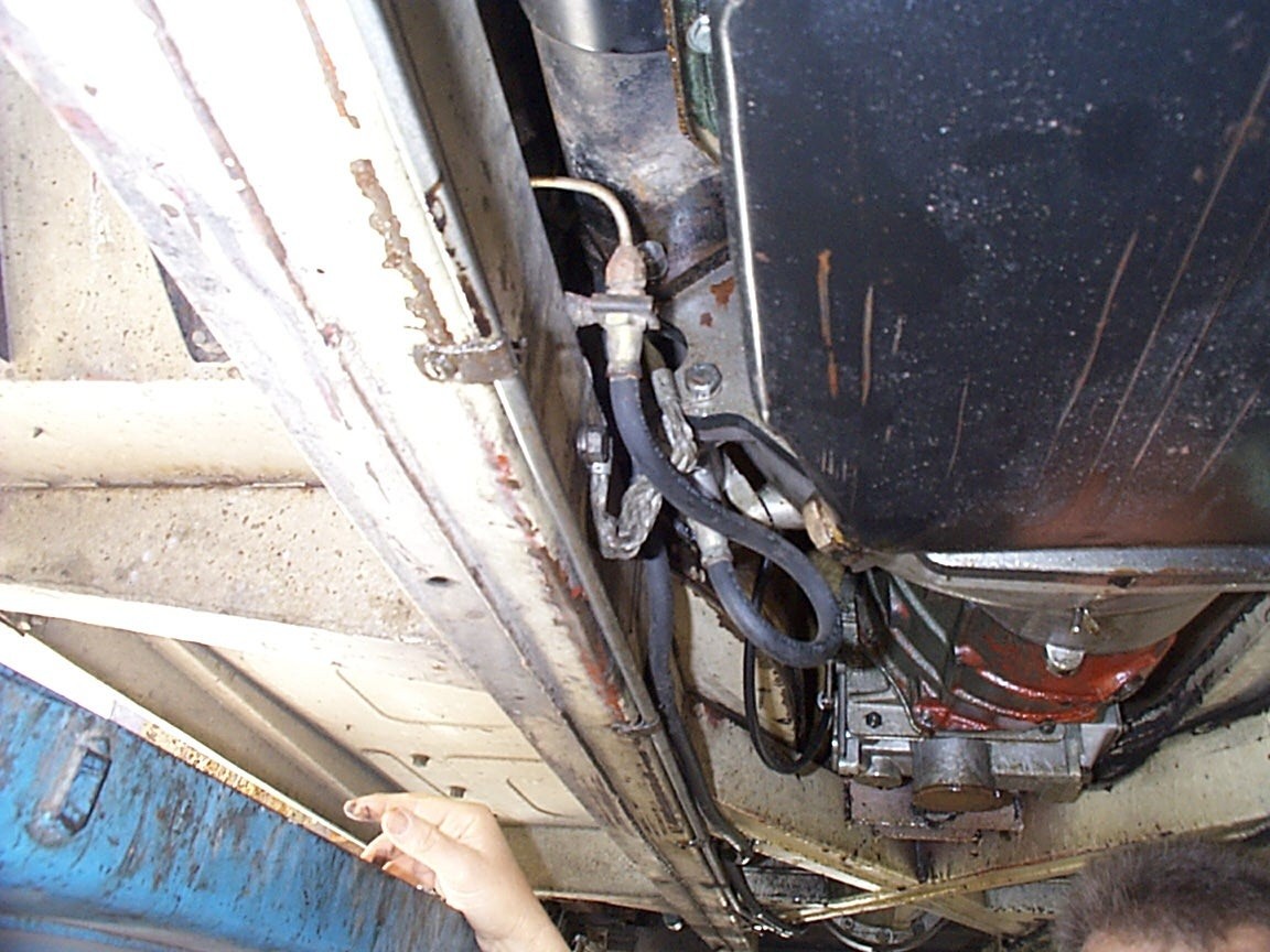

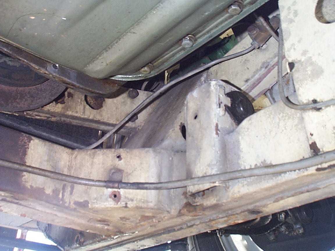

Some pics which may help.
Regards,
Greg

The fuel line runs along the chassis rail on the rhs in both lhd and rhd cars. I can supply more pics of the fuel line if you require them.
Regards,
Greg

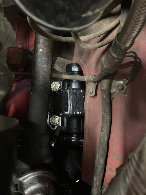

More photos.
