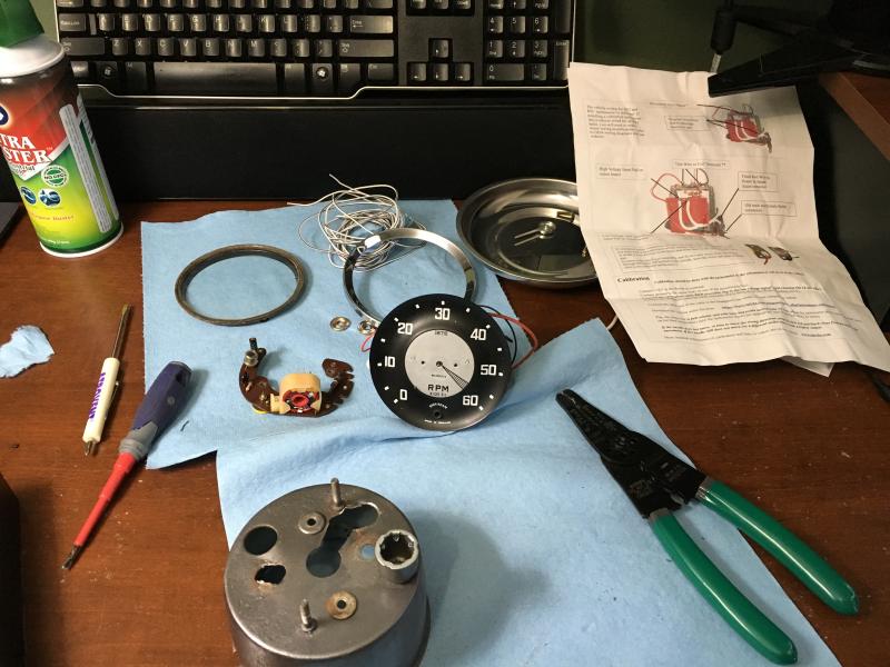

SD Bugeye
Started life as a mech. Tach. Then RVI now RVI with Spida electronics.
Old bugeye tach going thru its 2nd major rebuild and possibly 6th minor component crappy transistor...replacement now all new state of the art electronics and RVI movement
hopefully the last time I have to go in it.
