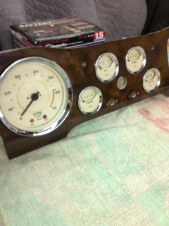

justin_mercier
The TR6 large spedo and tach are an odd size that's very hard to find at 120mm. I wanted to go with the new Smiths magnolia line of guages, and the spedo and tach in that line of gauges is only 100mm, so I had to make an adapter bezel to go from 120mm to 100mm.
S

1976 TR6
