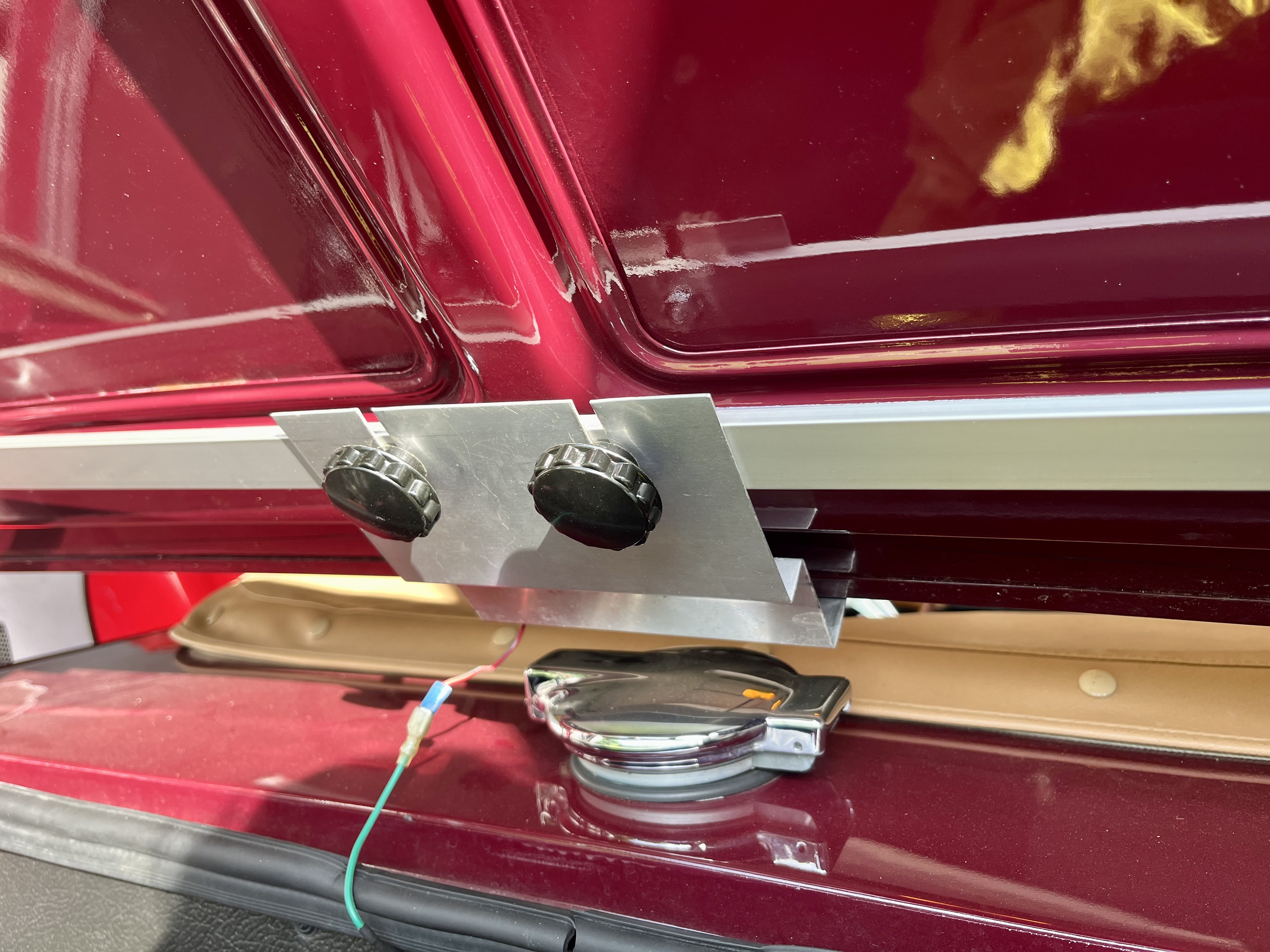

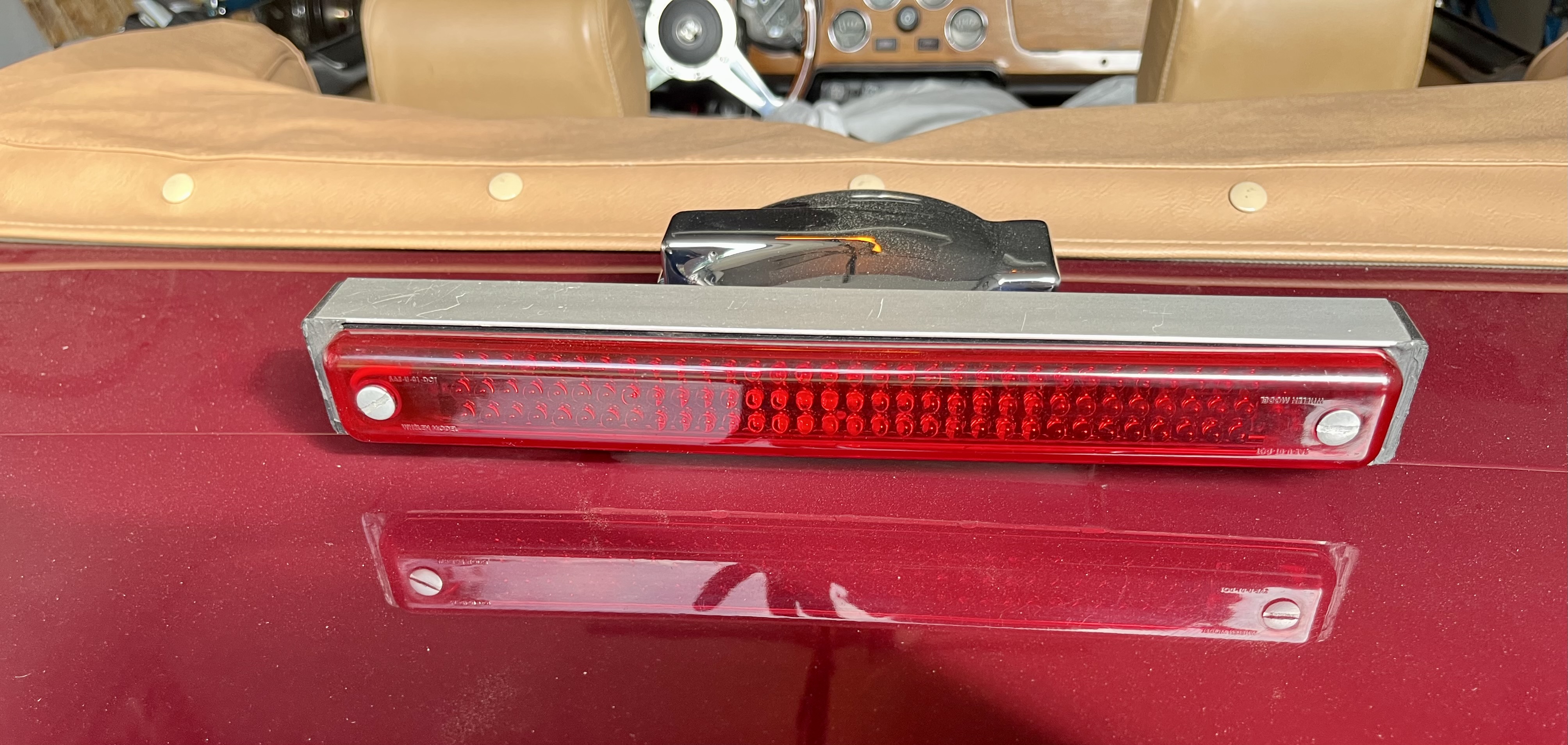

I built my own third brake light for my TR6. I wanted it easily removable for the times I go to shows. The brake light flashes quickly then goes to steady red. Inside the trunk lid I have two knobs and a quick disconnect for the power. I can totally remove the brake lamp in about 15 seconds.

Nice install Elliot! I have done several that had luggage racks. Fished the wire into the weep hole in the front inner
structure and up into the rack .Speedway sells a nice LED in a alloy housing that can be neatly affixed to it.
