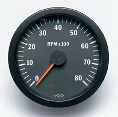

I would do some eBay shopping and see what you can find. Used tachs from VDO and AutoMeter show up regularly and any 4-cylinder tach with the proper ground can be made to work with the A-series. You could always buy a used Smiths RVC type tach for your temporary installation and use its electronics later when you are ready to convert the Bugeye gauge.
I am partial to VDO tachs. Gundy (David) bought a VDO tach for his Spridget. His became a temporary/permanent dash addition after he bonded a chrome Smiths bezel to the front.

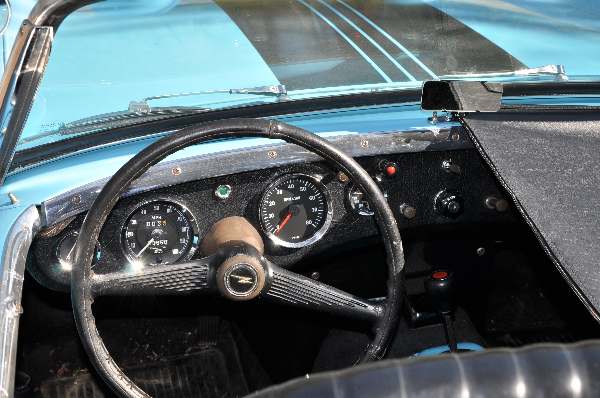

Getting one to fit in that stock hole is the problem.
I found a VDO which fits perfectly. In fact it fits so tight I never attached the rear bracket. I did put a chrome trim ring from a Smith's on it with super glue. As it is I can turn the tach so the 7K mark is at 12:00 for serious driving and just spin it back when done.
The ring is glued to the tach only and as such the tach is completely removable.
Excuse the brown steering collar. It's now black. Shoe polish did wonders.

Coastalman
I installed the same VDO tach as David and am very happy with it. Now I am working on putting the matching VDO Speedometer on my BE. Doug is helping me and is a wealth of information. He is bringing me the parts this weekend at a British Car Show in Raleigh. I will let you all know how it turns out, but I expect it to work as well as the tach.
