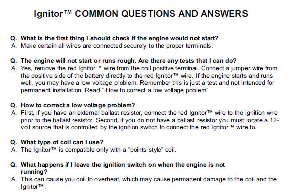

Indeed Pertronix warns against doing that.
I had the opposite experience with my current TR3; installing a Pertronix made it harder to start. Root cause was eventually discovered to be a bad battery (letting the voltage sag while cranking), but with points the engine would start and run fine even with the bad battery. (Until it got much worse, about 6 months later.)
I have had similar experiences with the Allison unit on my Stag (similar to the Crane XR700), where sagging battery voltage (due to driving without an operational alternator) caused the engine to just stop running rather than gradually degrading as it does with points. By my way of thinking, that makes the car less reliable overall (in terms of getting home under it's own power in spite of the bad alternator, as opposed to coming home on a flatbed).
Bottom line, IMO, they are good for reducing periodic maintenance, but not especially good for overall reliability. And it just isn't that hard or expensive to throw in new points and condenser as part of a major tune-up.

On leaving the key in to on position, it will eventually cause a coil problem with the mechanical system if when on, the points are closed as there will be a constant current through the coil.

I've had a Pertronix in for four years now and it's fine, but I do NOT leave the key on a long time. I do carry a drop in breaker plate ready to go with the points pre-set. Two screws, out and it. But I also used to carry spare points and condenser when I had points, so no big deal.
