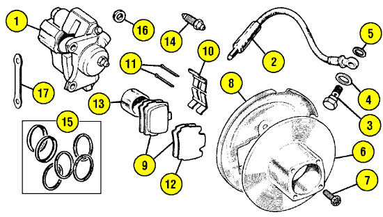

I'm installing the rebuilt a-arms etc from Eric Jones to convert my 62 to disk brakes. The dust covers that came with the original conversion parts from Ebay are rusty and bent. Are these parts necessary? At the risk of asking an obvious question - what do they do?

My new (VERY EARLY)1959 AH 3000 didn't come with the brake shields from the factory. Pad mileage varied from 900 to 1500 depending on the weather and the season. Later 3000's had the shields for obvious reasons. Yes, you do need them. Bob

They look like part # 8 below

Hmm - one yes, one no. I am thinking of leaving them off - well, not ordering new ones to install I guess - and keeping a close eye on pad wear.

I have to add some info to my rant above on the lousy performance of the shieldless disc brake pads on my AH3000. Firstly the Healey had terribly small brake pads to start with considering the weight and performance of the car. Secondly I drove the car all winter in snow, sand, and salt. Also it was driven hard and autocrossed every opportunity I had. My point above was that it only took the factory a few months to recognize their mistake and add the shields to the 1960 models. A Spridget driven sanely, in good weather, and moderate annual distances MAY not need the shields. Bob
