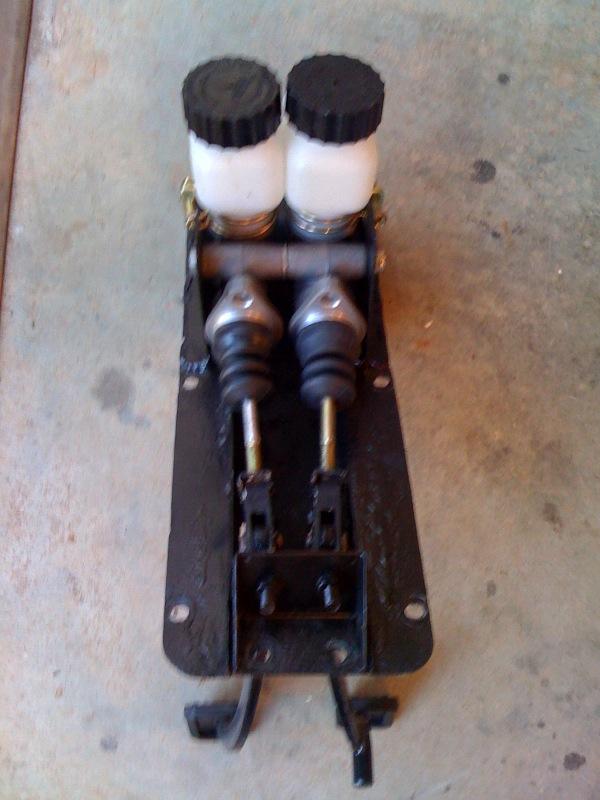

Rut, did you convert the master cylinder as well? I have fitted the front with discs, but have made no other changes yet. I don't seem to have very much pedal. So was thinking smaller master cylinder, later rear drums (with smaller wheel cylinders), etc would help. Just how much pedal do you have with just front discs fitted?
Rut
Bill, this is my set up using 2 Tilton 3/4" master cylinders. This is what I started with, so I can't speak for the original set up. I sent my original to Sierra to be converted and should have them back soon. I'm using the old style rear drum brake and the pedal is good.
Rut
