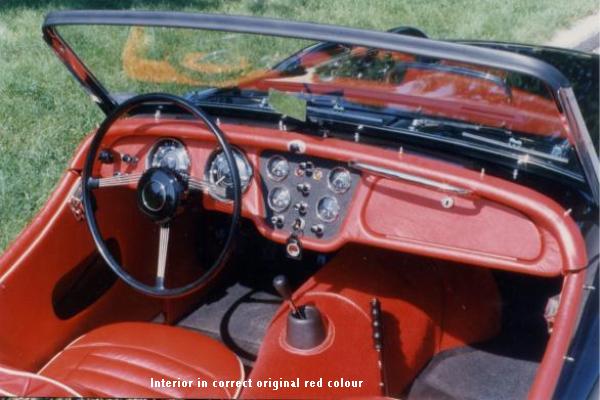

Mine is chromed with threads about 3" down from the top end. The handle at the top is hard black plastic (maybe bakelite ?) and it goes down over the top and threads onto the threads mentioned above. I bought a new one during my restoration but I found out it was a bit smaller on the outside diameter and it was semi-flexible. So I polished and buffed the oxide off the original one and sprayed it with clear-coat. It's almost 48 years old and still looks like new. See attachment

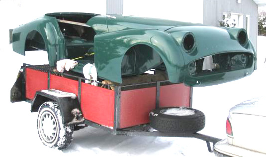

Every time there is a change in paint technology, enamel to 2-pack to the latest, etc. the paint suppliers re-formulate their car paints with a new mixing formula. Dupont and others have not re-formulated the 1955 to 1960 TR3 British Racing Green, so I took the closest that they had. Dupont call it Triumph Racing Green for a TR4. It is also known by some as "Conifer". The sample looked identical the BRG but once it's on the car, it looks like it has a bit more blue in it than the original BRG on the TR3A.
See the attachment.

Yes that is kinda what I thought too, that thing is nice. When I got my 58 back, it looked a little yellow for BRG, but it grew on me. Like you said, the people I talked to maintained that brg has minor variation. Jaguar brg seems to be kinda dark. I hope I get this one as nice as that snow bunny of yours.

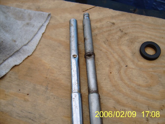

Hi tr3 people this is what I am talking about on the tr3 hand brake handle. In the attachment, the one is chrome with a push on handle and the other has threads but is not chrome. Perhaps the threaded piece is a ring small and came off with the old rubber handle. However, I cannot see where it was welded, but it does look separate on the other one. I am just curious if someone else has a tr3 hand brake with a handle that pushes on because I guess the push on is actually a tr4 and the whole handle is different. Perhaps they are both after market form the seventies. I do not know.

SP, All the 3 handles I remember from the garage were, as I think Don Elliott mentioned, like bakelite and threaded. Seemed like the more sun exposed the cockpit was the more likely that the handle would start to split around the threads. That's were they always seemed to break.
