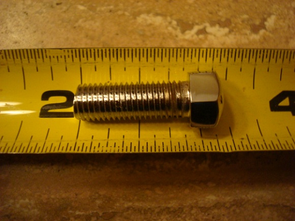

mallard
This is a picture of one of the original bolts from my car that has been re-chromed.
