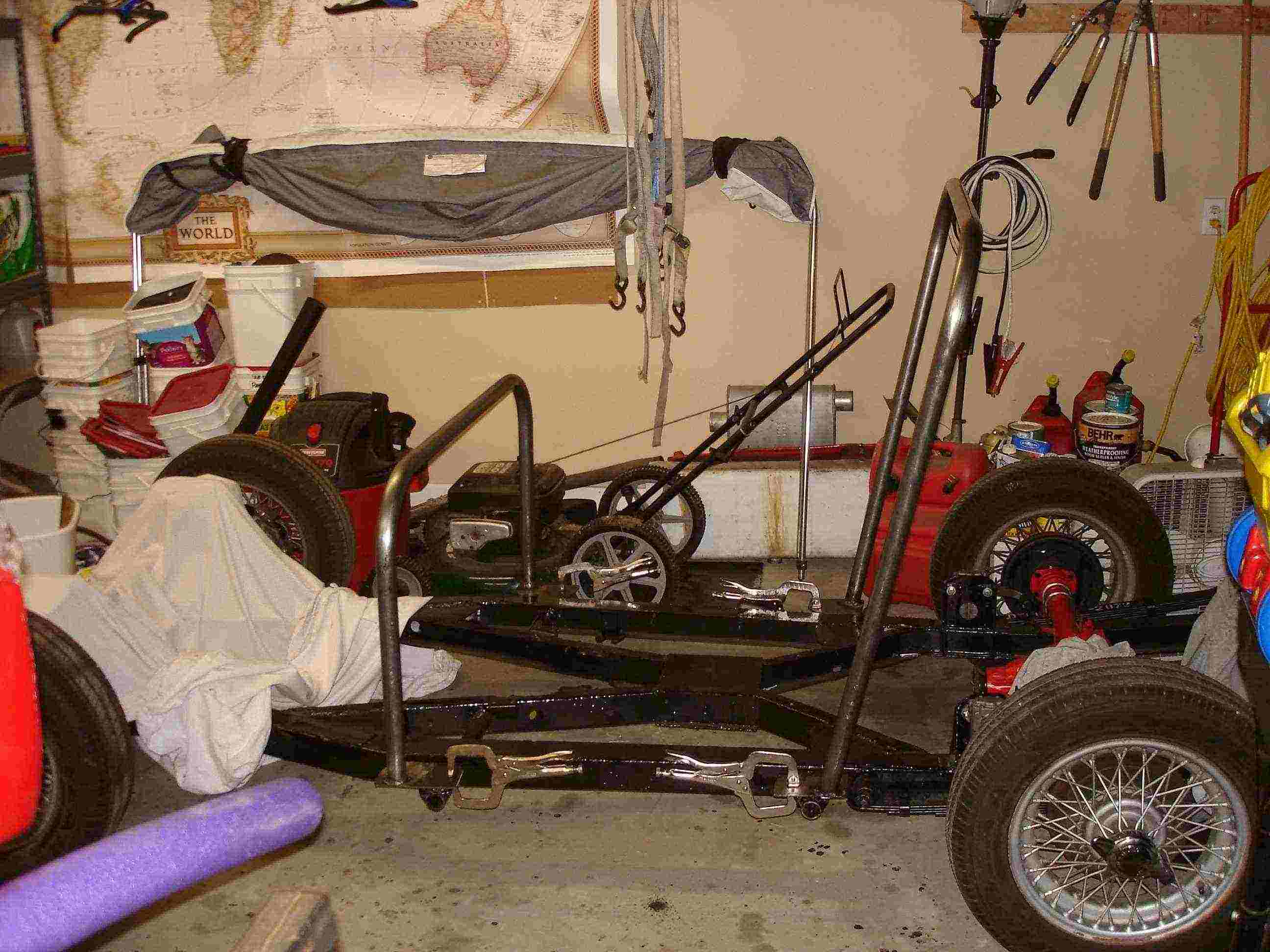

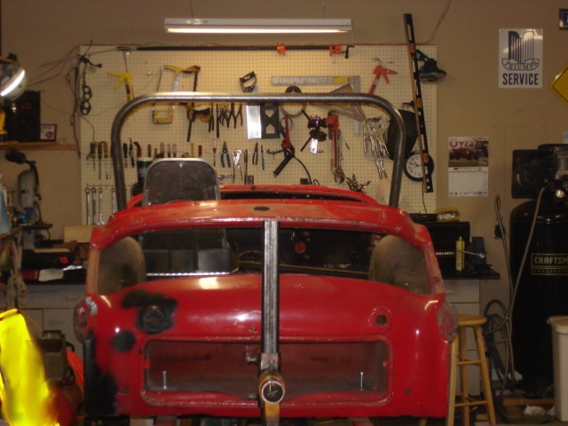

I am building a TR3 on a TR4 frame, but I think I saw another one out there somewhere.
Frame is complete, roll cage is complete, most major rust repair (inner sills, floors, B posts, rear tub suports, front inner fender are all complete. My goal is to have this thing running by the end of the year.
Since I started the project in 2004, my wife and I have been blessed with 2 kids. Needless to say my 1 year schedule slipped.
Last weekend I test fit the body to the tub to make sure I had all the monting points for my cage properly aligned. With the stock wire wheels, the tires are standing proud of the fenders by about 3/4". I think I will resolve this by ordering a slight offset on my alloys in conjuction with a slight roll on the fender lip. Next time I test fit the body, I'll post some more pics.
these are some older pics of cage in progress:
Greg
