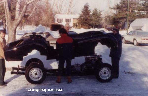

Don Elliott
Hewre is how we did mine on New Years eve at the end of 1989.
