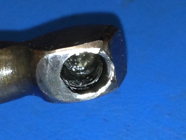

Just a follow up: I have it all apart again. The plunger in fact slipped out. The old spring is longer than the new one I bought from Moss. Odd. The old plunger is all chewed up, nicked and scored. The sockets of the shift rods seem OK but first/second is a bit scored. Hard to see, or to explain, but it's as if all the sliding created a bit a groove in that shift rod, whereas the rod for third/fourth has no apparent scoring. The socket of the shift lever does look rounded and a bit chipped. I guess I'll order a new one and see if that's the problem. Here's a picture so you can see what you think. Thx

Most of my cars trans don't have the spring in the shifter and they work just fine. Maybe your shifter top is just worn more than you think. I have several parts transmissions if you want to get a different shifter for it.

As long as the longer plunger is still short enough that it can still plunge to the required depth I would think it would help, I assume you used the longer spring under the "shouldn't hurt, might help" theory, which I makes sense too. Hard to guess without seeing it, but sounds like something in the mechanism is worn out of alignment enough to give the plunger some play, or perhaps some more interference or pressure than it is supposed to have, when in action. Good luck, agree with the idea of driving it around for a while with the tunnel off, although you said the last one lasted something like three months, don't know if you want to drive with the tunnel off most of the summer. the socket in the plunger being bunged out could certainly be an issue, I might have a spare shift lever, I used to have three spare transmissions, but they are all gone now, if I find one will let you know. The red 4A looks nice, like the wheels, Greg.
alanjohnturner
The answer may be in the first picture you posted. The hole in the shifter is worn out of round. The lip is also missing on one side.
This allows the plunger to "capsize" and wriggle out. Get a shop to bore this out and fit a bronze bush. If you cant find a better shifter that is.
