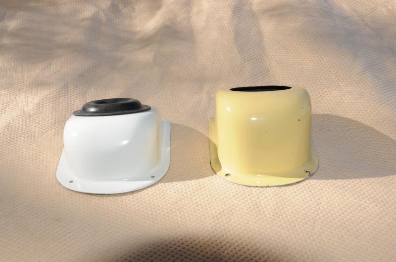

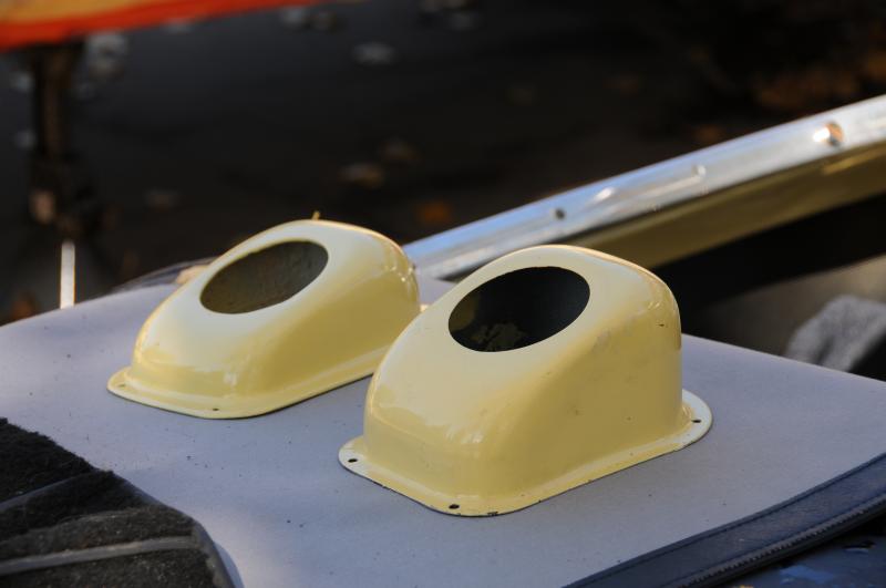

Jeff (known here as 67hardtop) has created a fibreglas duplicate of the BE shifter cupola in fibreglas, but an inch lower. It takes the standard BE shifter boot, but is now low enough to allow the five speed to be shifted without interference.

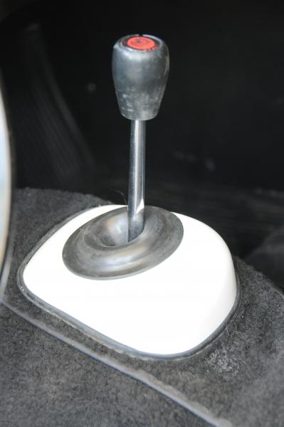

You can see the original metal, primrose yellow, version and the rattle can painted fibreglas semi-clone. Apologies, but the only photo if have of it installed is in the white, unpainted, protoype form. Jeff's looking into producing more if there's interest. It works well on our yellow 59, and we'll put one in on the 60 Silver BE as well.

Jeff and I had a look-see this morning, and our conclusion was that making the cupola wider etc. etc. etc. was feasible (remove the flange from the driver's side but leave the fore and aft flanges for mounting, but have the driver's side come down on top of the carpeting), but that there probably a couple of better options that would retain the stock look (for those who would prefer to stick with shortening the Datsun lever only, and not cutting and offsetting it:
1 - drill out the spot welds holding the 'lipped' portion to the transmission tunnel and move it sideways so that the cupola would work, and then reweld. Premade/precut carpeting wouldn't match
2 - cut an aluminum spacer to fit around the 'lip' and then slide the cupola sideways. This would raise the cupola about a quarter inch - we'll have a look at this approach in a month or so when we get to the second BE to see if the shifter would still work; carpeting issue
3 - cut the lip off/pound it flat/whatever and move the cupola sideways and mount it; carpeting issue
We think (no measurements involved here) that all of the above would work, without leaving a gaping hole on the right side of the shifter opening

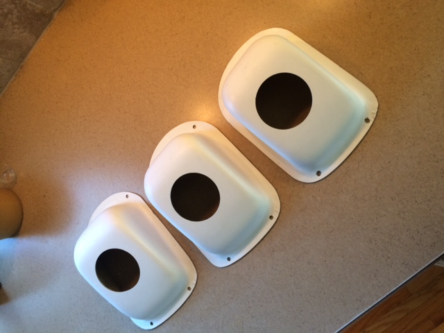

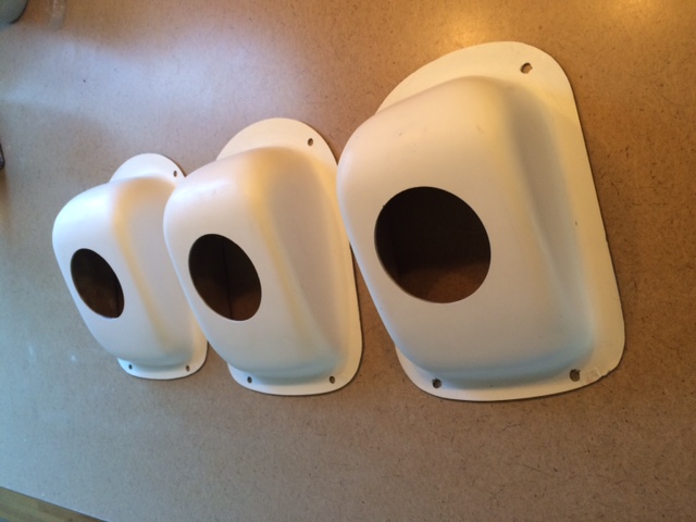

67hardtop
I should have parts in hand this week. Just finishing the plug and then the mold.
$75.00 cdn plus shipping should cover it.
Thanks
Jeff

67hardtop
I have three ready to ship(finally). I have more in process but the current temperature in Calgary is slowing my progress (small fortune to heat a 900 foot garage when its-20c to -31c /-24f) and my wife wont let me lay up fiberglass in the house, go figure. Upside is , I have the process sorted out so I will be quicker on the next bunch.

67hardtop
They are not perfect but they will do the job. I will make a few extras for you "wait mode" types and I can make more just about anytime.
Jeff
