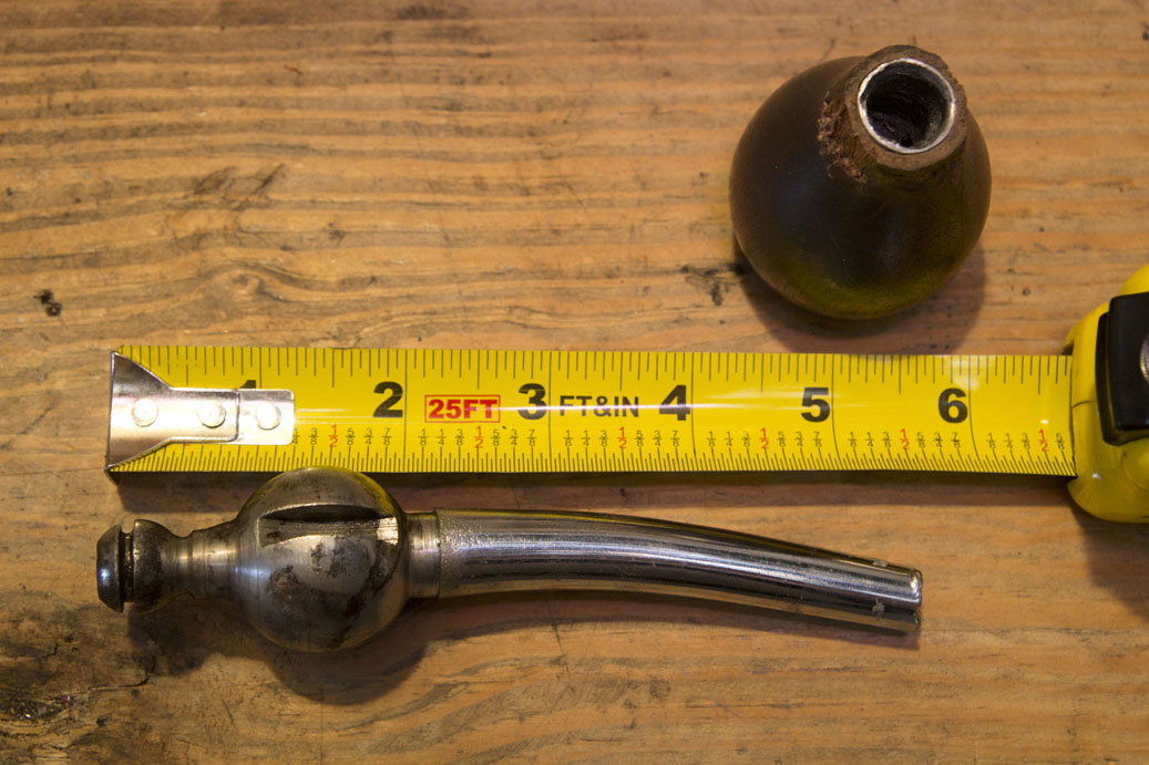

In an attempt to install a new shifter boot, I discovered that my shifter had been shortened and the shift knob glued to it... I would like the knob to be removable. In a case like this, would it be best to thread the end of the shaft, weld on another threaded section, or something else? Suggestions? Thanks!

Speedwell made a shifter extension back in the day. If you can not find another shifter. I would thread the end of the old shifter. Then get a coupling/all- thread nut and a bolt and make an extension to the length you like. If you find a Stainless nut and bolt no chroming required. I am having my shifter chromed now and it will cost $35.

Must have been popular back in the day. I have one that was shortened the same way.
You could drill a hole into the end and tap it and install a stud and knob (still would be short).

If you don't mind losing the chrome its easy to weld a bolt to the shortened shifter. I have shortened two of them and that is how I did it. Weld ground down and you can't tell anything was ever done to them.
