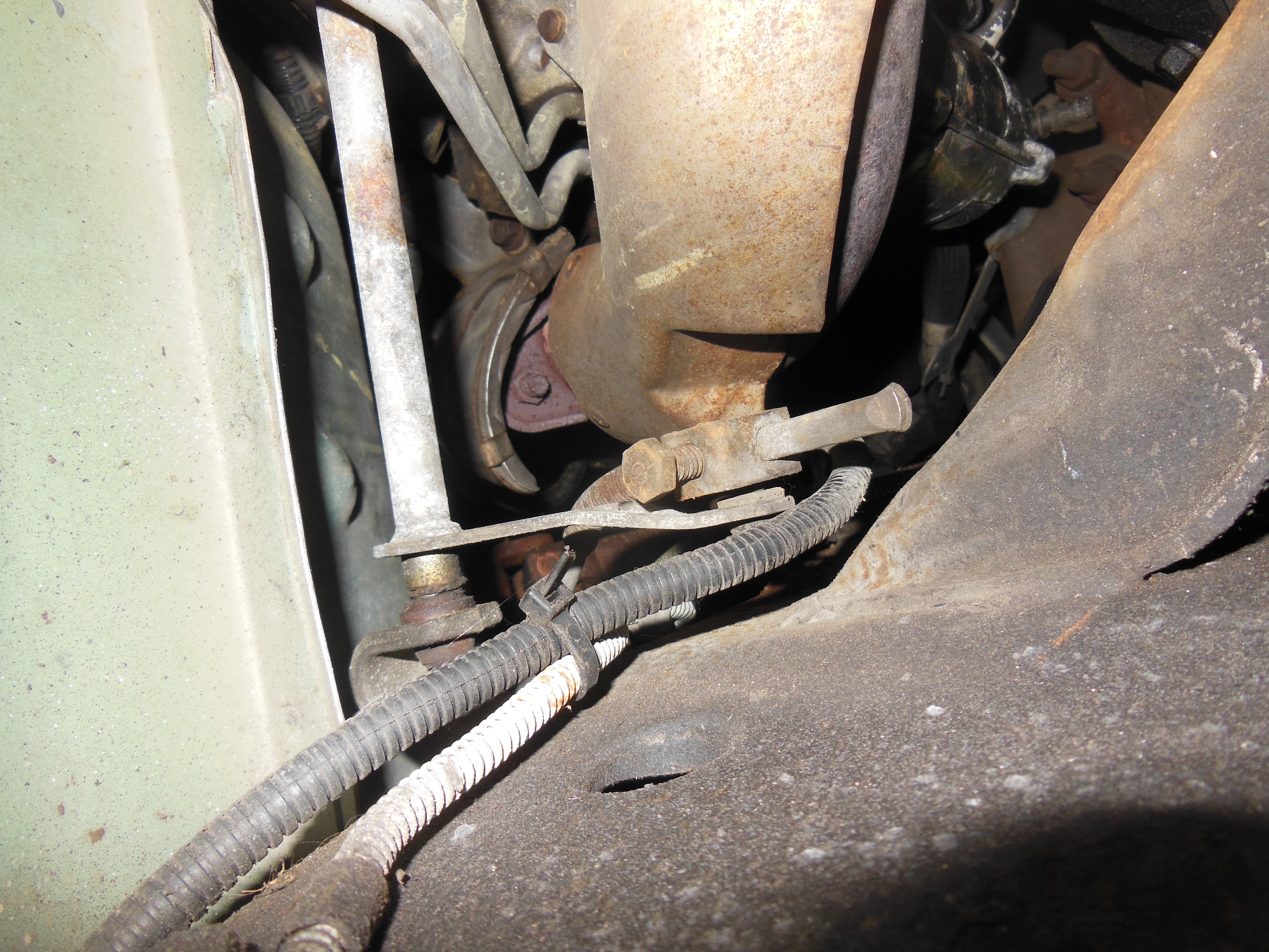

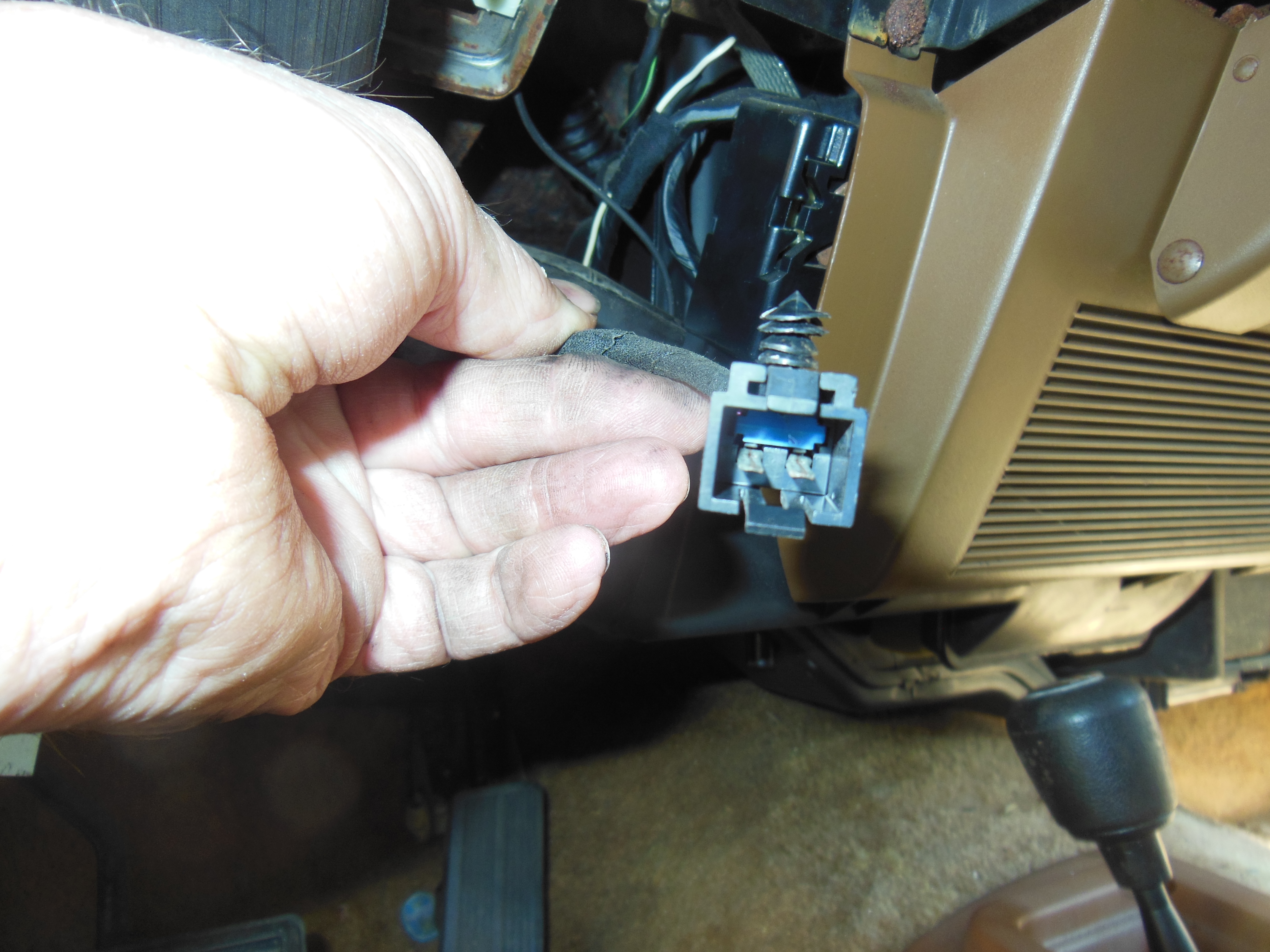

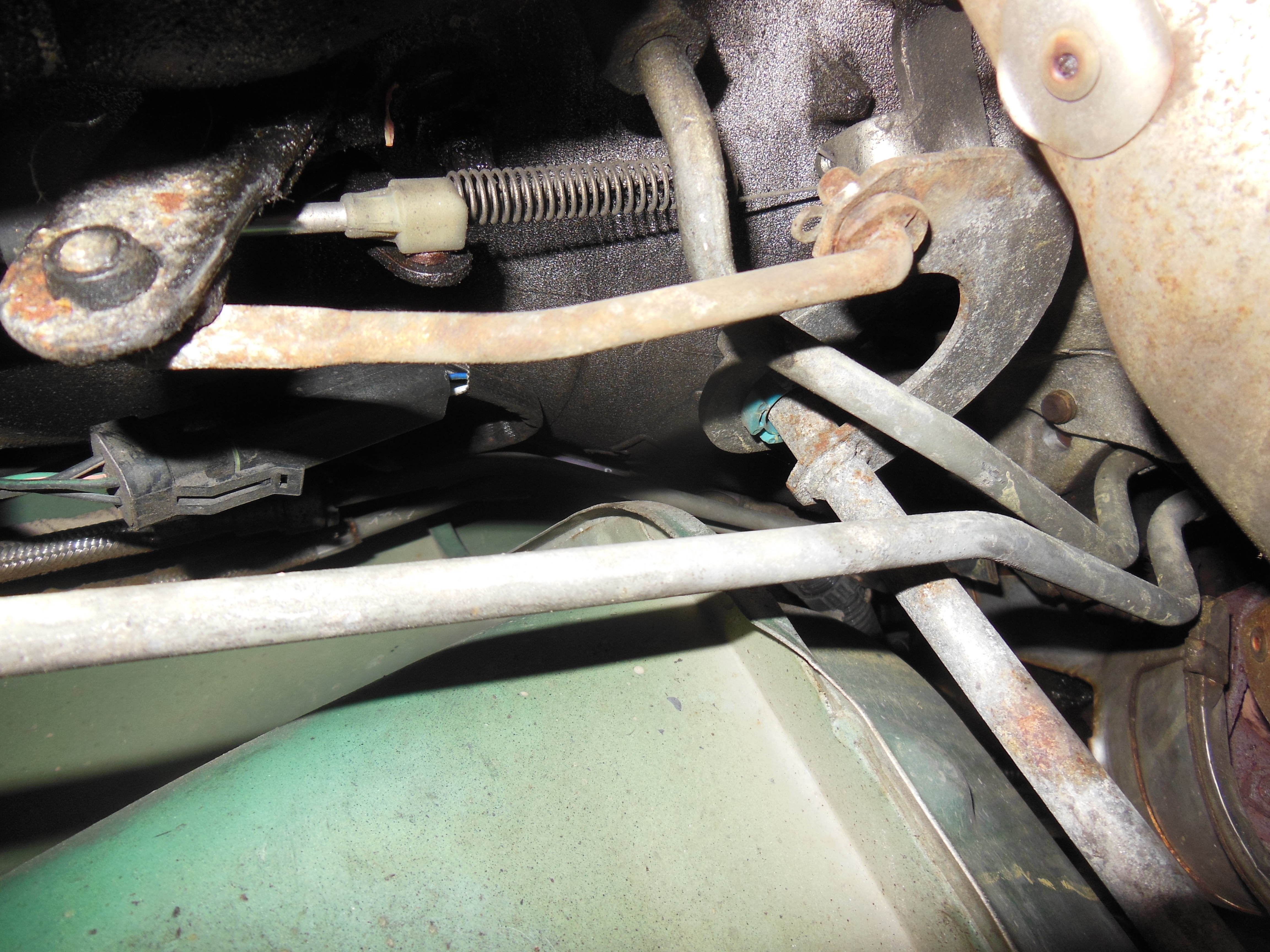

When I went under the truck, it seemed to me I could hit the linkage at the trans with a hammer and force the arm at the tyranny to go into park. Or loosen the nut on the linkage bar then force the trans to shift by hand and retighten the bolt. Does that sound about right? the picture of the plug. I am not sure of it just appeared after I dropped the column
