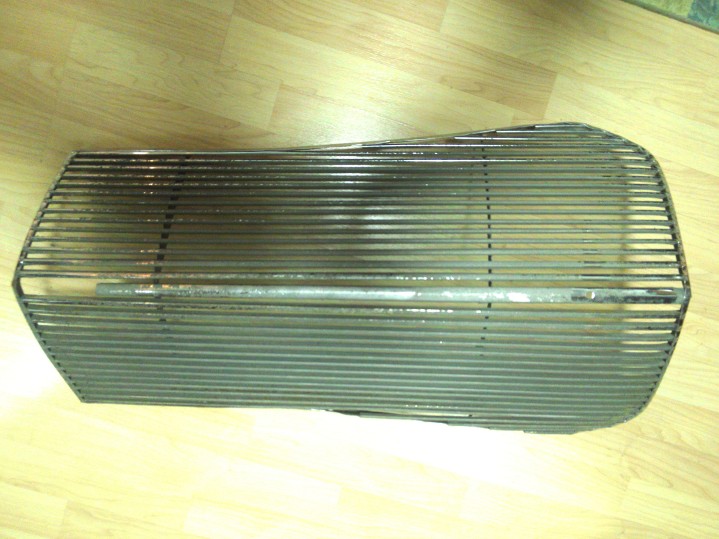

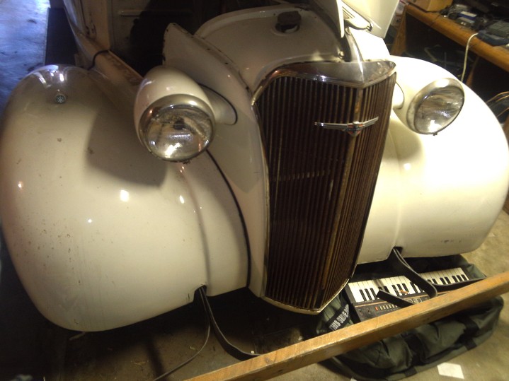

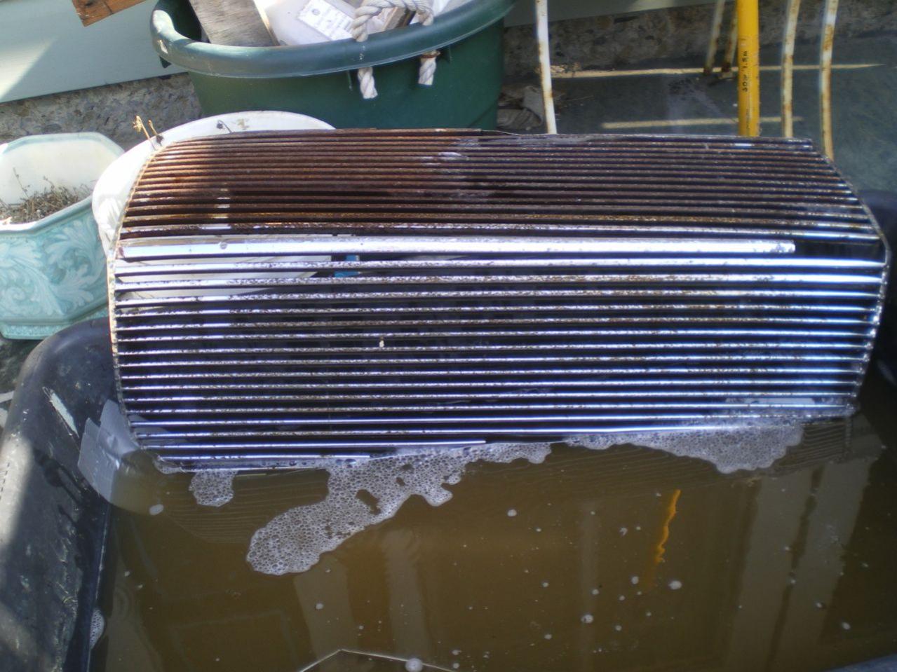

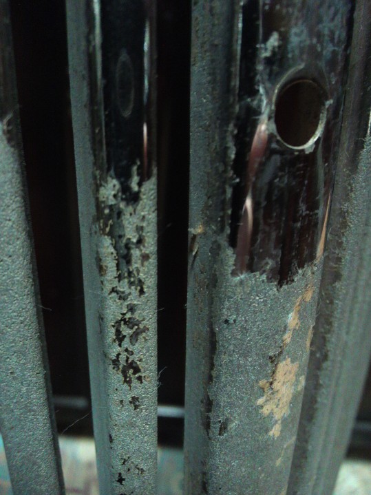

My '37 Chevy grille. Alternatives are to go with "Chrome" powder coat or paint it body color. I fear the cost of chroming may be frightful. I did email Knox Custom Chrome (recommended here) several days ago, but they haven't bothered to reply.
