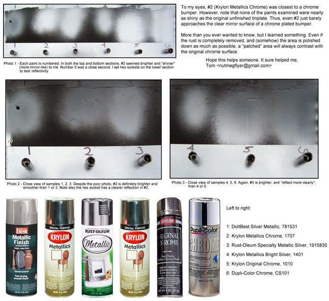

Here's a "chrome spray" comparison I did a couple years ago. I didn't have a chrome bumper to use as a test, so just sprayed on tinplate over black primer. To my old eyes, the result never even got close to the cap of the can.
Tom

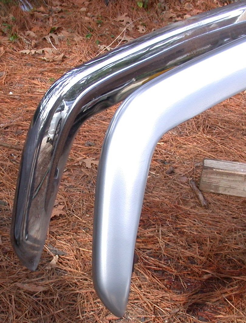

Hopefully the picture link below will work. The image is stored on a Google Sites location and it is sometimes difficult to past URL links to content. Since the info is cached on my machine it may show for me and not for you. Let me know if you can access the picture link.
The bumper on the left/rear is the end of the twisted bumper removed from our Spitfire. The one on the right and in the foreground was the one I sanded, applied etch primer to and then three coats of Duplicolor Universal Chrome. As I mentioned, you will not mistake the finish for chrome but to me it does look like an aluminum bumper.
We installed the bumper today and it is definitely serviceable on a daily driver.
EDIT: Assuming the picture link is working, you can see an even larger picture than the board software provides by right-clicking on the small image below and selecting "Open link in new tab" or "Open link in new window". That should give you the full-sized picture so you can look at the finishes in greater detail.

I bought some Duplicolor clear and tried it on a sample of the chrome paint. As with most "aluminum paints" I have used in the past, when you spray clear on top, the finish goes from shiny to grey, very grey.

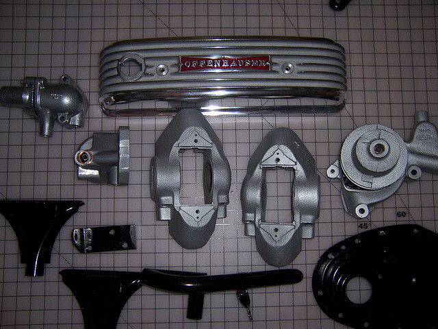

Here is a picture of Eastwood's Powder Coat 2 part reflective Chrome (the Triumph TR3a Thermostat Housing). I have plenty if you want to give it a try on the grill, I can send it to you, if you return the left over. It is great for parts that are not traditionally Chromed, but it is just not Chrome. For an object as visible as a grill, I would go with Chrome. West Coast Chrome here in Modesto has a good rep.
