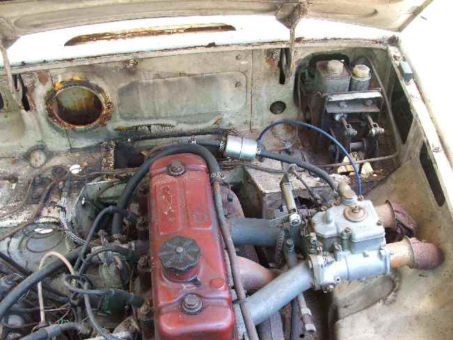

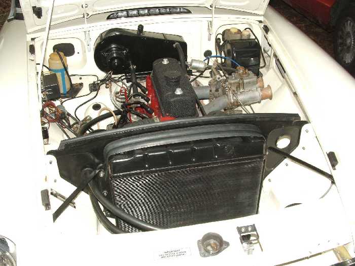

Did Her MGB with engine in, as a "panel repair" job. One side at a time, pulled EVERYTHING away from the sides and masked off.Did it in polyurethane with a gravity fed gun. It came out passably well.
Before & After:

After...
davidk
Re: Spray painting a TR6 engine compartment commen
"It came out passably well."
I'd say it came out "passably great"!
