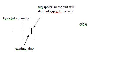

I'm stumped. Removed speedo and on the bench it's fine (using a bit of square cable chocked in my drill). On car, no go. I know the cable is spinning when the car moves. What could this mean? End of the cable still looks good and square to me. Weird? Maybe wrong cable and when I rerouted it won't work? I don't think so. I'm thinking a small spacer behind the stop....at least they're not expensive...if that's the problem.

It should pull out easily. The cable just fits into a square hole in the drive gear in a manner similar to the speedometer body. It's easy, however, to think you have it all the way into the drive gear when it isn't; it only goes in something like 3/8" if I remember correctly.
Both ends should be square in cross section, about 1/8". Are you sure the one at the speedo end isn't rounded off or something like that?

I added a little spacer and I cut off just a bit of the end that goes into the speedo as it was rounded off ever so slightly. Speedo works now. Then I went to pull the cable back out as I thought I should grease the snot out of the spacer I added and the cable didn't want to come out of the casing. I packed grease in the end and reattached. Hopefully it still works tomorrow.
