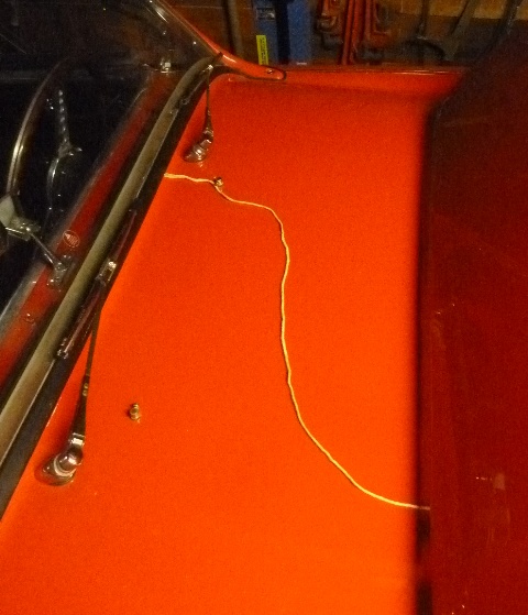

I laid out this string to follow the path from the rear of the tach (near the spray nozzle) to the firewall, made a sharpie mark there; followed the cable from the firewall to the tach.
Total length of string: 44". Plenty of room between the heater and shroud to accommodate the additional 4" for the 48" cable.
